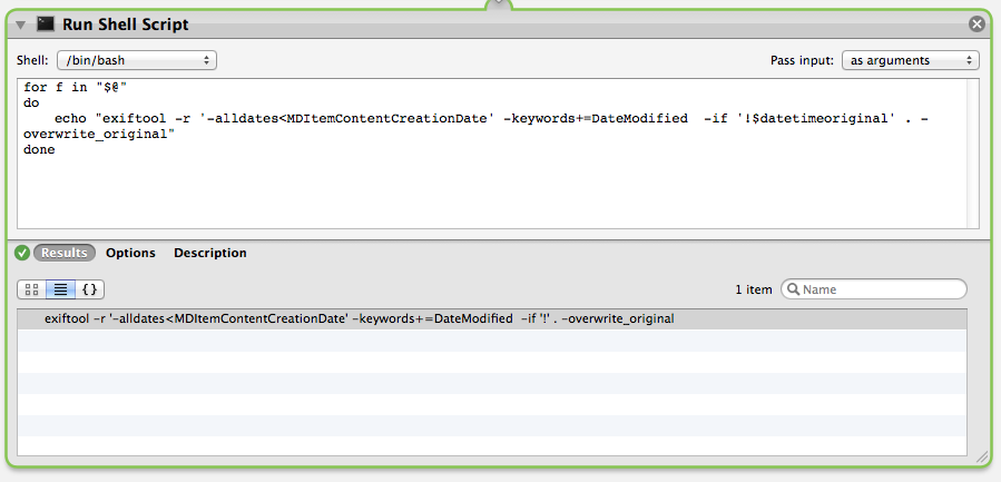

This is the complicated part and I first thought you meant replace that entire line (shown in bold above) with ther Exiftool terminal command, but receiving an error message I tried to replace just $f with the terminal command (again within quotes) and pressing "Run" gave me an all OK in the results section, so I must have done something right.
In other words, my shell script looks like this:
Make sure you have verified backups of every image file you use in testing. If you completely bork the image files, you can restore them. If you're working without a safety net, not so much.
Yes, I've created an "originals" folder and of course a "test" folder. After testing I can replace the files with a fresh batch from the "originals" folder. All copies of course!!
So at this stage, if everything is set up correctly, the files should actually be processed by Exiftool, or just simulated to do so? None of the files have had their Exif data change so either it doesn't work (despite the green tick alongside "results") as you can see here along with the results:
So at this stage, if everything is set up correctly, the files should actually be processed by Exiftool, or just simulated to do so? ...
Given what you posted, it's just simulating the command. More specifically, it's echoing the text of a command, but it's not actually executing it.

If there's a problem with my main Mac it's quicker and easier to troubleshoot that way.
PS: I just tried adding the above code to the shell script but it didn't make any difference.
Hey, it worked on my laptop!!! 🙂 That is, the script worked (I've only tested it within the Automator application so far) without any error message and my test files got their EXIF date tags as intended.
So obviously there's something wrong with my MacPro setup which needs reinstalling. Until then I'll keep testing with my Macbook Pro instead.
At first I was told exiftool couldn't be found, so I added the full path to the script which fixed that (I don't have any .bash_profile on the laptop, but it could find it in the terminal anyway).
So, just to avoid any confusion, here's the Automator script I've just tested and succeeded with on the laptop:
- Get specified items (the image test folder is dragged into here)
- Filter Finder items:
[All] of the following are true:
[kind] [is] [folder]
- Run shell script
Shell: [/bin/bash] pass input: [as arguments]
Code:
for f in "$@"
do
    /usr/local/bin/exiftool -r '-alldates<MDItemContentCreationDate' -keywords+=DateModified  -if '!$datetimeoriginal' "$f" -overwrite_original
done
Looking very good so far, so next I'm going to re-read your replies and do some more testing to see if I can get it fully working as intended now that I've uncovered the main problem.
At first I was told exiftool couldn't be found, so I added the full path to the script which fixed that (I don't have any .bash_profile on the laptop, but it could find it in the terminal anyway)..
Congrats on getting it going.

I did check the environment variable where it turns out that Automator doesn't see the /usr/local/bin/ path (Exiftool is located at /usr/local/bin/exiftool) so I added it to the top of the shell script. Still, entering the full path for exiftool instead should work just as well, shouldn't it?
OK, just to eliminate any obvious issues, here's what I've done in Automator:
1) created an Automator "Application"
2) "Get specified items" action (with the test image folder added)
3) "Filter Finder items" action with this setup:
[all] of the following are true: [kind] [is] [folder]
4) "Run shell script" action with "/bin/bash" shell and "Pass input as arguments" with the following:
Code:
export PATH="$PATH:/usr/local/bin"
for f in "$@"
do
done
UPDATE: I just noticed a small, but apparently significant detail: if I remove the space between -if and '!$datetimeoriginal' I also eliminate any minor exiftool errors as the ones I'm trying to eliminate in PNG files (adding EXIF headers to them is apparently tricky though I'm getting there). Some of the Automator errors might actually have been due to the various PNG files I've been testing with (different files contain or miss different EXIF, XMP etc. tags).
I'll see if I can get a similar result in Automator with the new exiftool command above...
PS: how do I add comments to the Automator shell script? I'm assuming a hash character (I can't seem to actually write it here as it confuses the forum posting and won't let me do it) at the start of a line, but is this regardless of word-wraps, just depending on a line break character (pressing RETURN)?
UPDATE 2: OK, I think I might have figured it out. I slightly moved things around with the exiftool command like this:
Code:
for f in "$@"
do
exiftool -r "-XMP-Exif:DateTimeOriginal<MDItemContentCreationDate" "-XMP-xmp:ModifyDate<MDItemContentCreationDate" -if 'not $exif:datetimeoriginal' "$f" -P -overwrite_original_in_place
done
Does its syntax look correct? As with the previous script, removing the space after the -if also removed any minor error messages. Why does this make a difference, and will it cause other issues if I do this?
