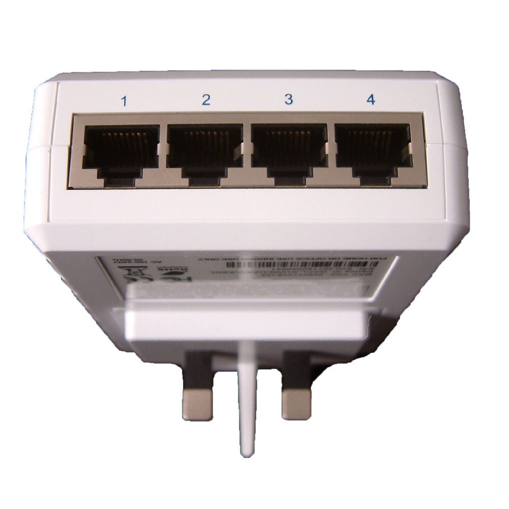

Had the wrong one posted, you could use something similar to this with EU Pins of course.
And that is?
A powerline I assume.
Well, I already thought of that, but the power here is on different subnets and I think it will never work well here.

And that is?

Powerline Plugs:
I had kinda problem in my friends house a couple of years ago, then found out that the more junctions/splitting wires there are the weaker the signal gets.
Odd thing was, it wasn't working well on the second floor just 10 meters away but in his Garden house/swimming pool which was 30 meters away it did which was on a different phase.
Powerline Plugs:
