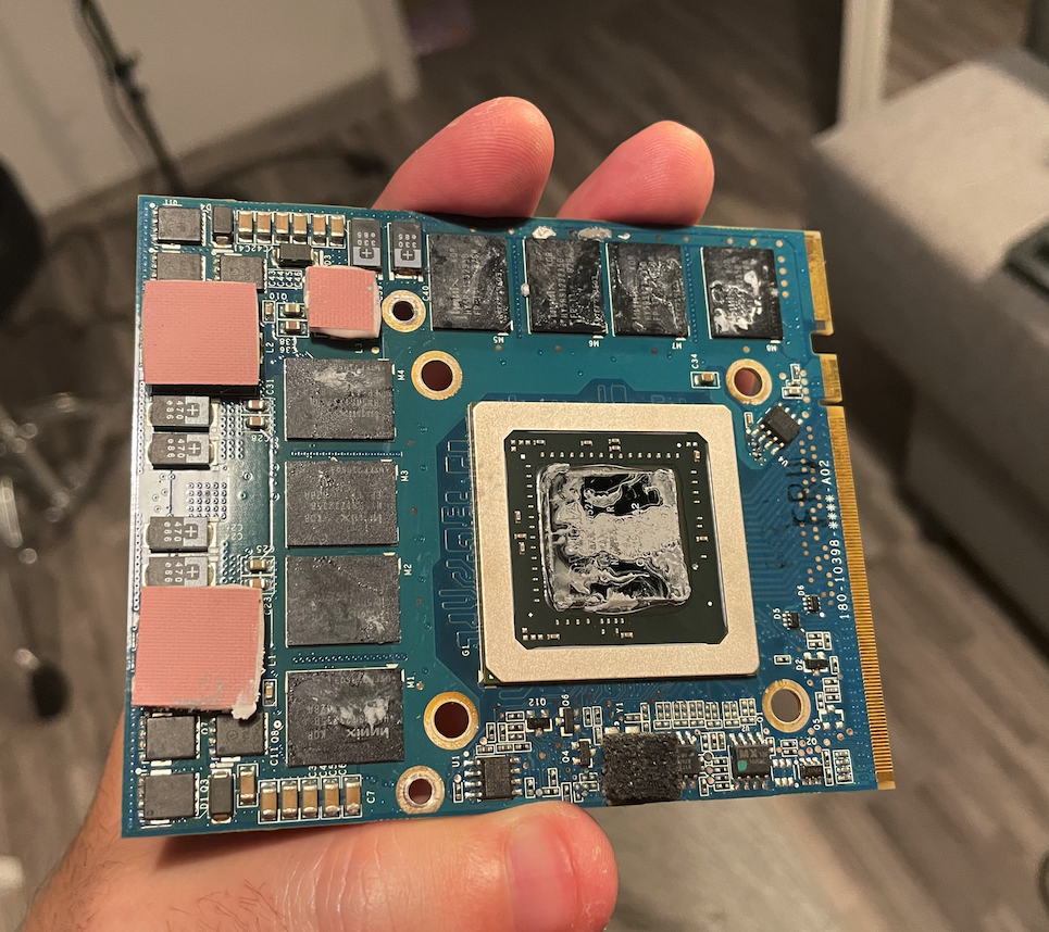

Unfortunately a few months ago it stopped booting, a couple of seconds after the Apple logo, it kept restarting automatically. Tried everything software based, reinstalling HS, EC but the installation was not even starting. Verbose mode was not helping so much, at some point a message was repeated but in internet I did not found too much help. Decided then to start checking the hardware. Managed to get the Apple hardware test for my model booting from usb and showed no hardware errors. I was a bit puzzled. In any case, I decided to open the iMac and try to disconnect individual components to see if without any of them it unlocked the installation. Tried removing ram modules, swapping them, disconnecting Bluetooth card, speakers, wifi card, SuperDrive, even hard disk, etc. No luck, so the failed component had to be something else. The main board Leds were all green. So then I decided to focus on the graphic card, the 8800gs that was already replaced in the past. Even if I did not had the same symptoms of other people, decided to dismantle everything and remove the card. People was suggesting to put the card in the oven for some time. This sounded kinda fancy for me and decided to go for the other approach, which is to replace the card. Given my experience with with the 8800, decided to go for an ATI 2600 Pro, which is less powerful but more solid from the reports. Ordered the part in eBay and when it came, I realized that the heatsink of my current card is not compatible with the ATI(my bad!). So, I ordered a correct heatsink and assembled everything. Took the opportunity to do a deep cleanup of the interior and re-pasting of the cpu/gpu. Pluged the Mac in and voila ! Installation was done perfectly ! The machine is running beautifully since a couple of months!

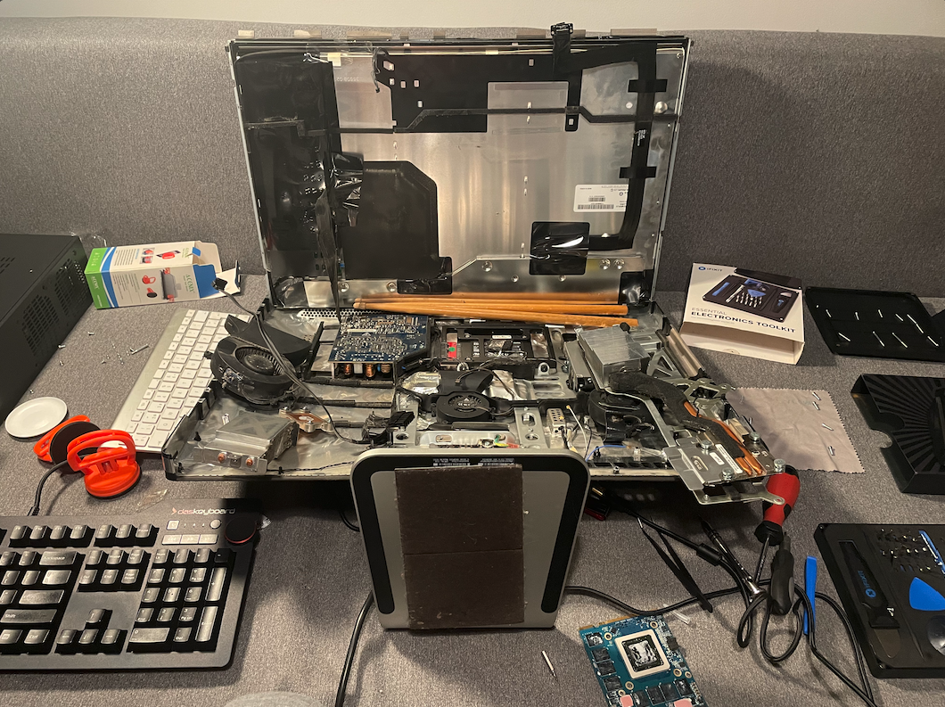

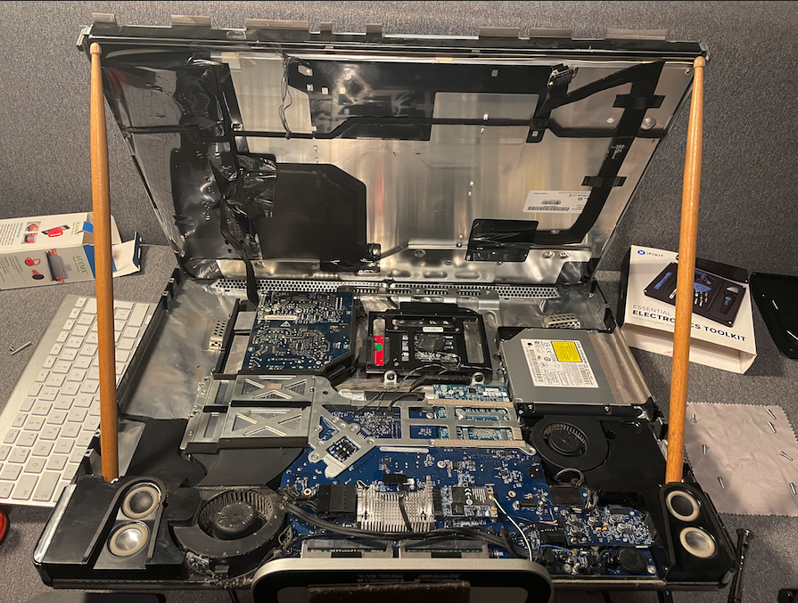

Some photos of the process (drummers 😉 ):
Empty:

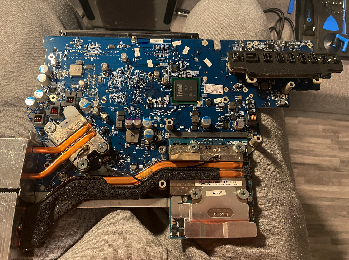

Logic board
The offender:

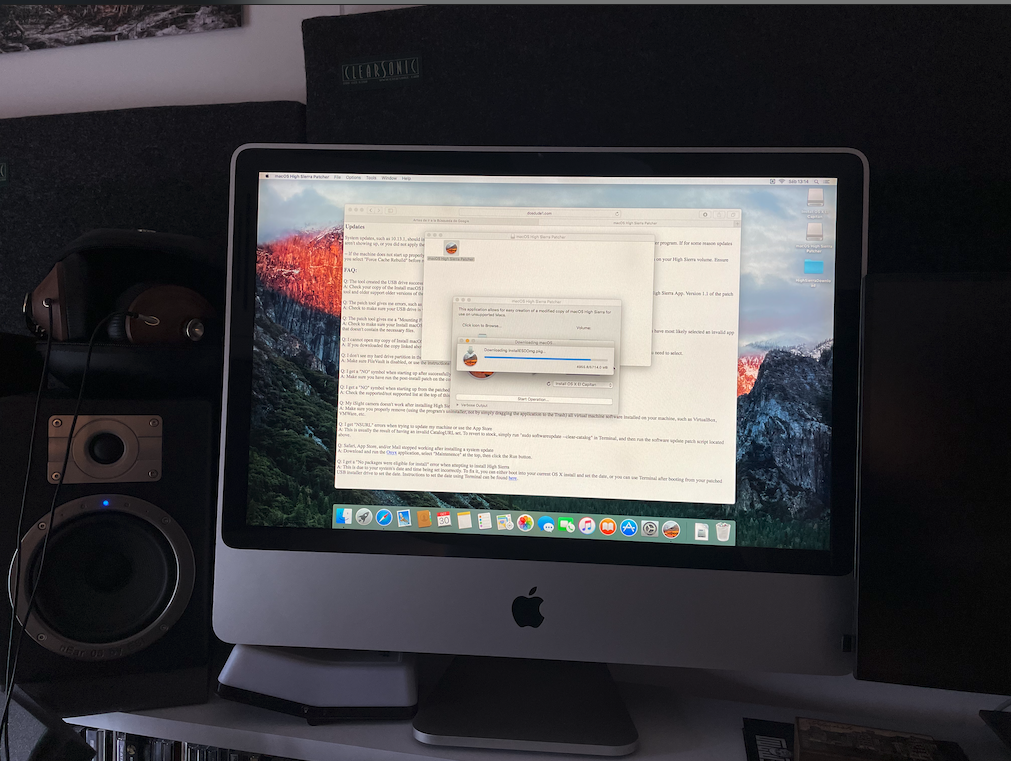

Back to life:

Empty:
