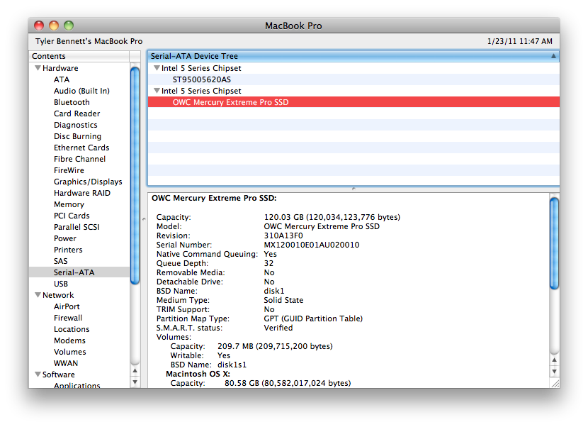

I cant really tell if it runs sandforce but if it does this is what you need to check, see the revision number in my screenshot. If yours doesn't begin with 310, then avoid putting OS X on it and im not sure but that 343 may also cause the problem your having now. I know I say avoid SSD in optibay but im doing testing now with mine because im having problems getting the HDD to sleep in the optibay and its killing my battery.
My pmset -g looks like this if anyone is wondering and I have no problems at all.
