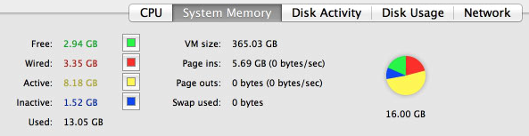

Here is what my 16GB rMBP running a RHEL6.3 VM with 2GB memory allocated to it looks like with nothing else running. It works just fine with other apps running, too, such as Firefox, Outlook, etc. The Linux VM doesn't do much that's memory or CPU intensive, either.
attachment.php
