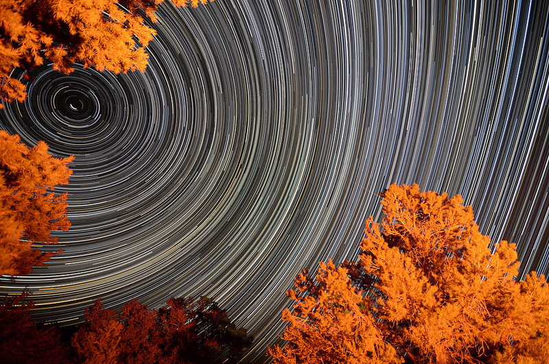

If you get too many stars it becomes more abstract.
This was my first stack. I was trying to catch meteors and left the camera setup for six hours. It was in the dark skies over Death Valley last year. The pine trees are lit up in about 100 of the frames by our campfire. As you can see there was no wind that night. Very unusual considering we were at 8000 feet.
Since I didn't catch any meteors I looked up stacking when I got home. This is the unedited JPGs right off the camera. I also worked with the RAWs and removed the airplanes but didn't end up with a better final image.
These are really great! Thanks for posting.
