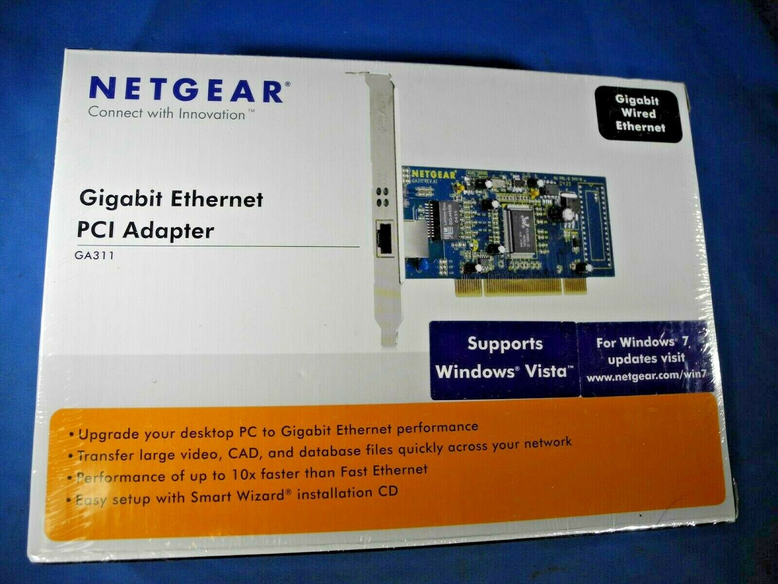

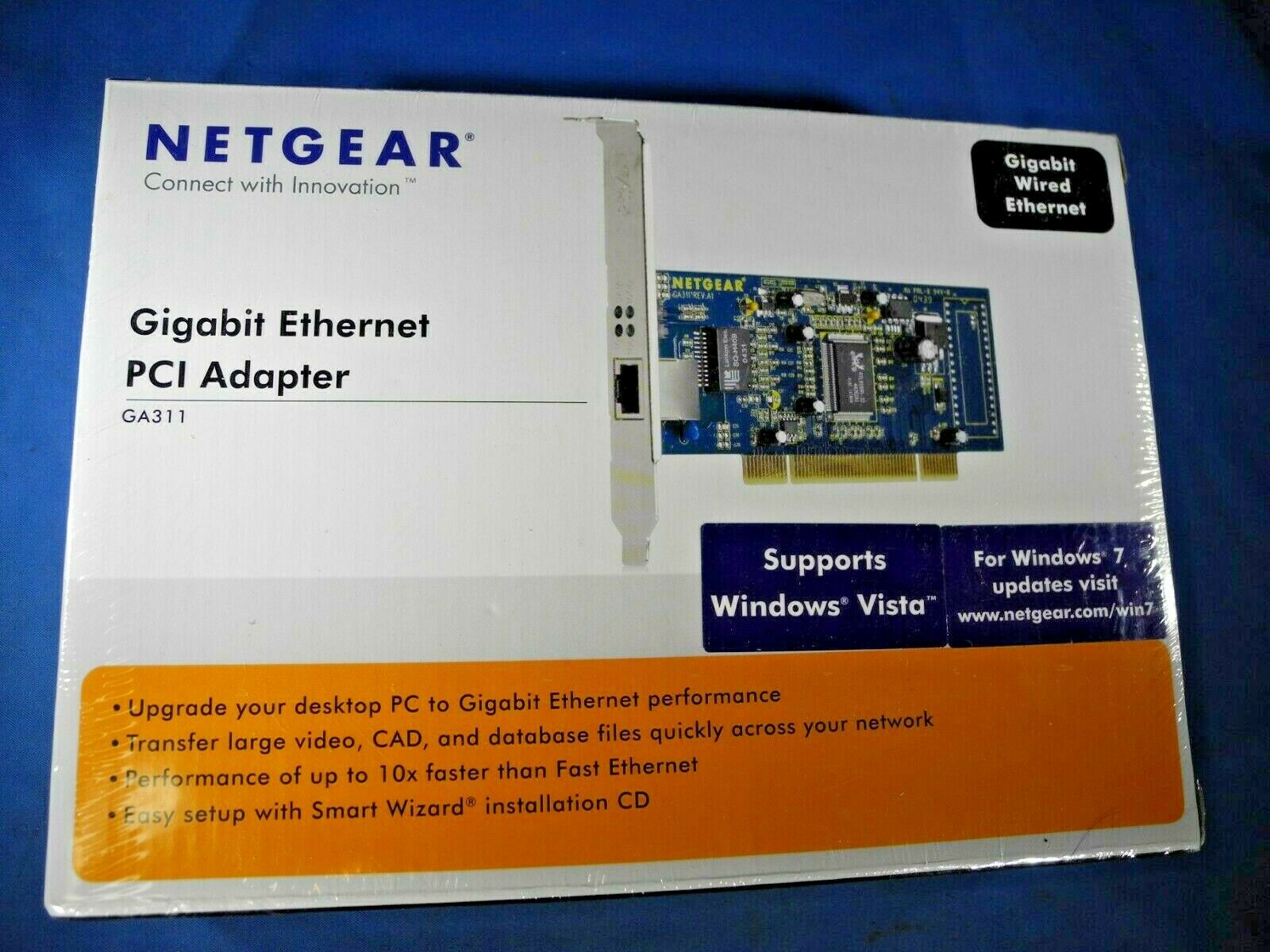

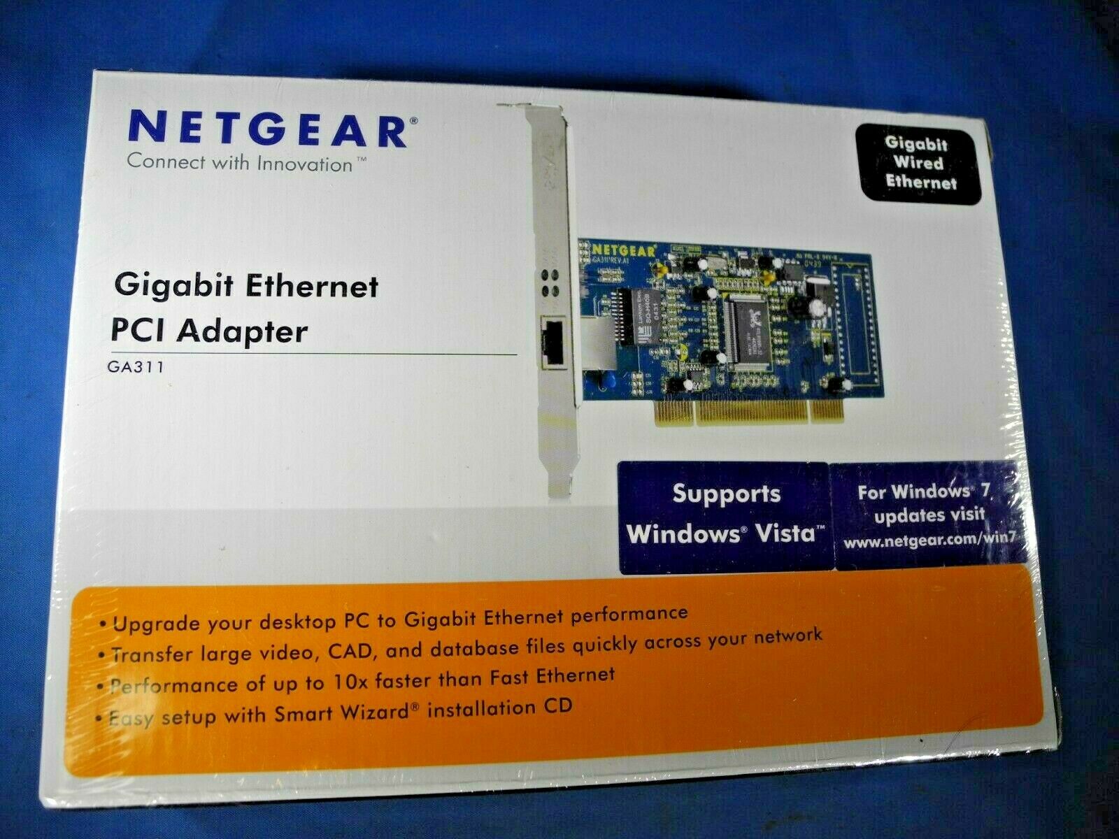

For Gig-E I would recommend an actual PCI card. Netgear GA311. These are cheap on eBay. I have two in my G3 Server (OSX 10.4.11 Server) and one in my G4 500mhz. No drivers necessary, they are immediately recognized by the system and just work. You may have to open System Preferences>Network first though.
Of course they are limited by the PCI bus, but they do well. I just replaced a 10+ year old one with one from eBay for $14.65 - tax and shipping included. Getting one would free up your adapter. 🙂
This is a good option.
I have a couple 64bit length PCI NICs from an xserve that also work out of the box in Tiger and Leopard, not so limiting by the regular PCI slot.
They were on eBay for around $20 but I don’t see any right now searching “xserve NIC”.

I actually did buy an hp branded nic with the bcm5703 but I couldn't get it to work in my sawtooth. Does it need to be an apple branded one?
No. The one I mentioned above, the GA311 (picture up there too) is Netgear.
It is always possible that because I have the server version of Tiger on my G3 there were drivers installed I suppose. When I installed the same card in my G4 it was already running Leopard. So I can't definitively say it works in a Tiger client Mac I guess because I didn't put it in one that ran Tiger client.
But this card is circa 2006 or earlier. It's been around for quite some time and it does work on my systems.
I can confirm the xserve one works on Tiger client.
I have a PCI 10/100 card that is not Apple branded thats in my Beige G3 that also works in Tiger client. The only non-Apple branded PCI gigabit NIC I have is installed in a PC, and I don’t know what chipset it is. I think I installed it in a G4 one time to see if it would work and it didn’t.
Basically the rule with things working in Macs; is if it has the same chipset as something Apple sold/included in a Mac it’ll work. Like the netgear eyoungren mentioned. I actually have the PCMCIA version of that card and I use in it my Pismo. I can confirm it does work in Tiger client. It however does not work in Jaguar or OS 9 (if anyone was wondering).

What's interesting is that the Netgear card was a 'see what happens' card. I had two of them from work sitting around at home for a few years before deciding to drop them in to my G3 and seeing what would happen. I didn't expect anything - especially after I tried a different branded card first. So, I was surprised when they showed up and worked with no hassle - and no drivers to install.
Just one of those things where I happened to have exactly the right card.
That's also why I spent some effort poking around on eBay for this specific card when the old one failed.
