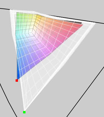

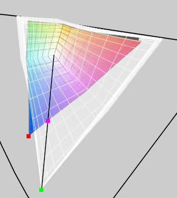

    That will just be the slow pixel response of the panel—normal with any LCD to varying degrees.
    The reason it's changed is probably because the LUT had to reduce the amount of blue to get the white point to D65:
    [​IMG]
    (top-right)
    If I had not used white-point tuning, it would have stayed the same.
