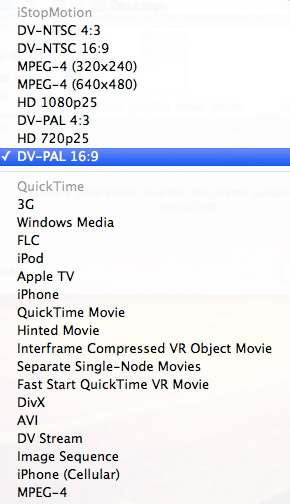

-> iSM is ging my a number of options, but not all of the above, in fact, only DV Stream. (See my attachment)

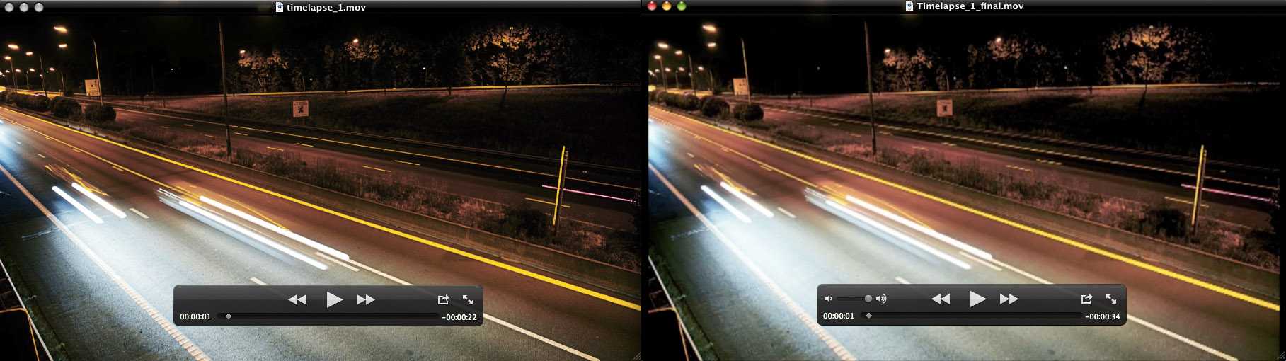

I could try this later today, but I'm not sure it will help, because when importing the DV file from iSM into iMovie, I can already see immediately the loss of quality (loss of sharpness, jagged edges, etc). See my second attachment to illustrate the difference between the movie in iSM and the import into iMovie. After exporting from iMovie, I can see no extra quality-loss, it looks exactly the same as the import of the iSM DV file.

..."Codecs to to try are H.264, AIC (Apple Intermediate Codec), DV Stream, Uncompressed 4:2:2."...

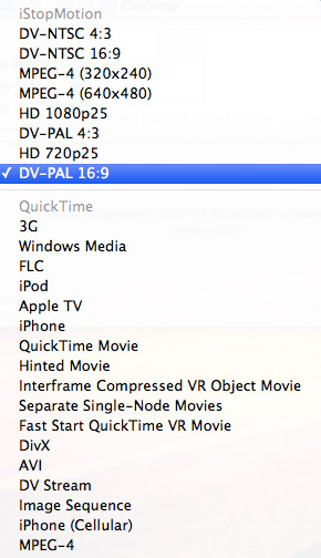

Select the 'QuickTime Movie' option and then click on the 'Customize...' button. You'll find more possibilities via that selection. See my iMovie export guide on things you can do from that. The guide really discusses the standard QuickTime exporting tool which iSM uses when the 'Customize' button is selectable.

It sounds to me like you should be exporting full HD, HD 1080p25 or HD 720p25 from the pop up, or a more custom setting using the 'QuickTime Movie' option mentioned above. Under the 'Size' option in the QTM export, try selecting 'Deinterlace Source Video'. I suspect that otherwise the video made will be interlaced, which is why the jaggies (the differences in your two images) are so prevalent.
So, with an iSM project that is HD, you want to export up to 1920x1080 HD, deinterlaced video to a QuickTime file. From what I can tell the 'HD 1080p25' option with deinterlaced selected in the Customize section should work out for you.
