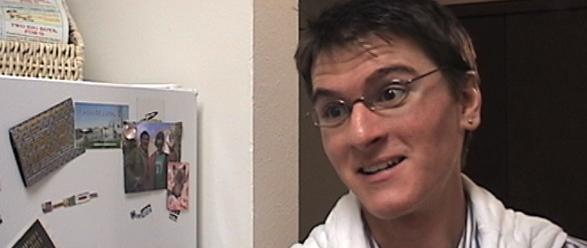

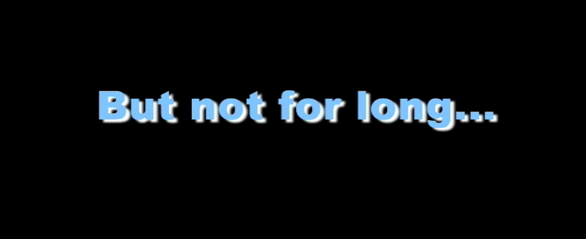

I'm going to try to export again, and I'll take a screen capture of each format (one at "As Quicktime Movie" and the other using Quicktime Conversion with H.264).

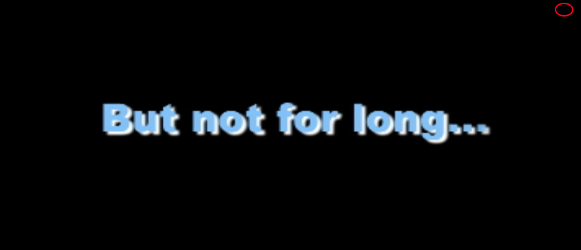

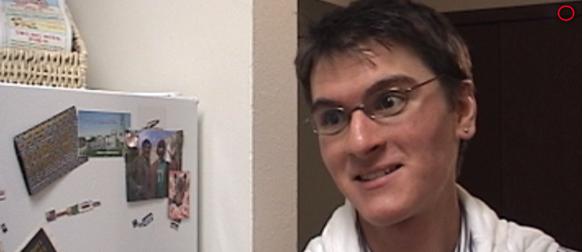

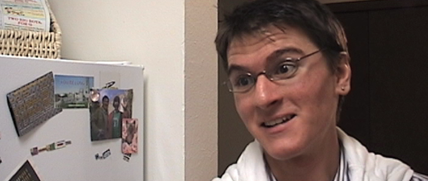

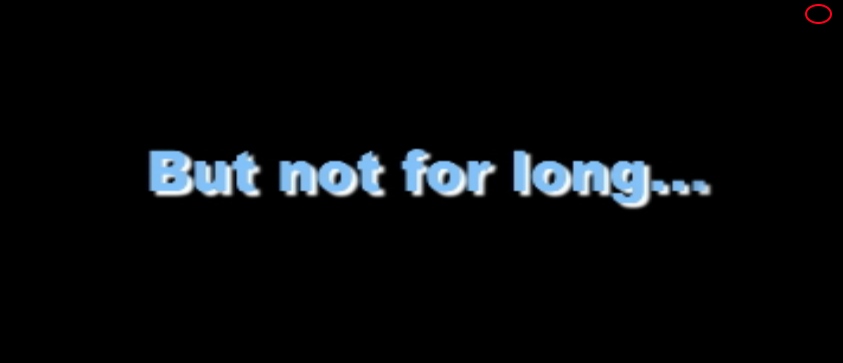

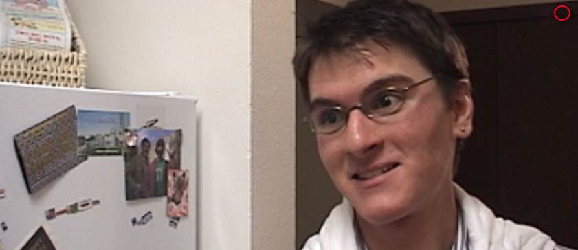

Ok, so here is what I did. I went to went to FCE, and I exported a "As Quicktime Movie" (which I thought would give the highest quality). Then I exported as "Using Quicktime Conversion" using the highest H.264 settings.
Below, are two screenshots of both versions. Both screenshots were relatively taken at the same time. The "As Quicktime Movie" version has a red circle on the top right hand corner for identification.
1. By eye-balling it in the first shot, the H.264 version has more clarity specifically around the subjects face and also in the top left hand corner (the menu's text, on top of the fridge.
2. In the second shot, the H.264 has better text hands down.
What gives?!

I can't see the difference in the text. The face detail is clear though.

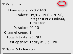

I think you should post the codec details of each file. Open in QuickTime and do a Command-I on each to see what they are.
Ok, here's the info. Again, the one with the red circle represents the video that used "As Quicktime Movie" for exporting.

Can anyone offer me a solution based on what I've posted?
(The question is why exporting "As Quicktime Movie" doesn't produce the highest quality image)
