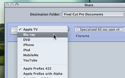

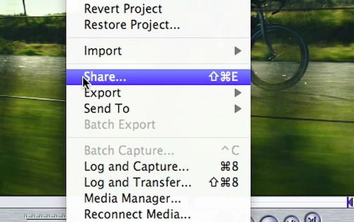

If you want HD, you can either use the Share feature (chapter 14, page 1717)

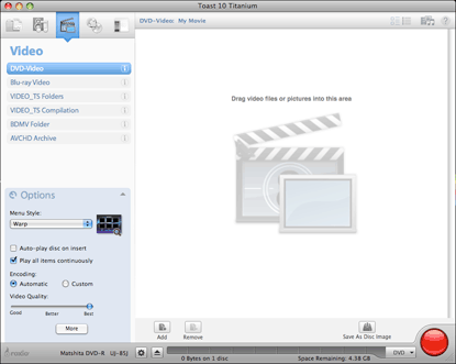

or use Toast, as it can burn Blu Ray content to norma DVDs. But you will only get 30 minutes or so of video.
