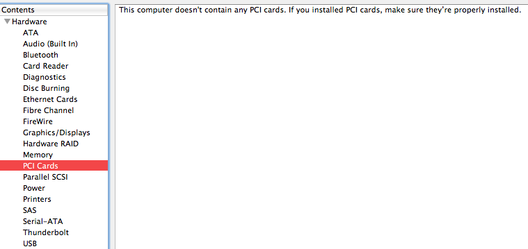

This might be a good time to set aside an hour and a small screwdriver kit with Step 19 of this iFixit guide — taking especial care to inspect both the ExpressCard cage ribbon cable itself, as well as inspecting how securely the ribbon is inserted and locked into the ZIF (zero insertion force) slot.
Before you open the bottom lid to do this inspection (and maybe a partial disassembly to reach the cable), open System Profiler/System Information utility (in Snow Leopard, Applications > Utilities > System Profiler.app; on later OS X/macOS versions, “System Profiler.app” is called “System Information.app”).
On the left menu in System Profiler/Information, you’ll want to look at either “Hardware > PCI” or “Hardware > PCI Cards”:
Check this tab after you have an ExpressCard inserted in the ExpressCard slot for testing. If it still shows the above message, “This computer doesn’t contain any PCI cards…,” or then it means the system is not receiving data from the ExpressCard bus. (This message appears when there’s no card inserted on a properly working ExpressCard bus and also when the ExpressCard bus cable is not connected properly to the logic board.)
If that’s what you’re seeing, then yes, this may mean you need to open your Mac and have a look inside. Fortunately, getting to the cable and inspecting it in the unibody model is a bit easier to do than it is with the pre-unibody MBPs.
It may be a long shot, but it’s possible you’ll find that during a past repair/disassembly (before you owned it), the ExpressCard ribbon cable wasn’t seated completely inside the ZIF socket before it was locked in place. There may also be just enough of one side of the flat cable to make contact with the socket to deliver basic power (to the one ExpressCard you managed to get a light to appear). This, however, may not be enough for the system detect there’s an ExpressCard bus connection it can detect.
A third possibility is the cable itself was damaged previously, which you won’t be able to know unless you’re able to inspect the whole cable. To do this requires following the above’s guide’s steps to at least Step 28.
Let us know how it goes.
