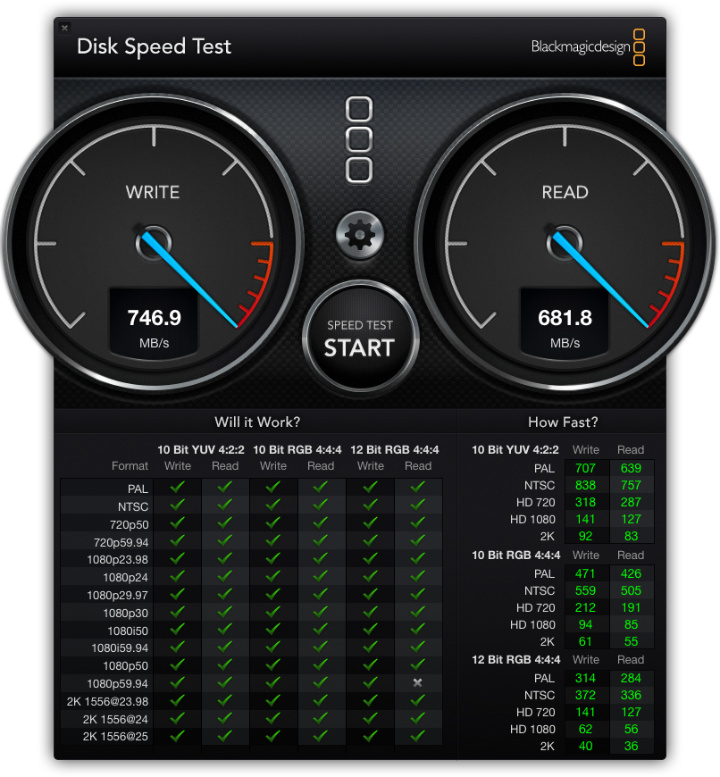

Just happen to have the same card. Are you also using the internal port? I am using the internal port and not the ext. Wondering what kind of numbers you are getting if using as internal RAID 0.
MacPro 2008 3.1 | 14GB Ram | Quadro 4000 | MC6.0 | OS 10.6.8 | MOTU HDX-SDI | ATTO R644| LaCie 324

I'll try and post my results, the write speed looks low. The test was on a OWC 120G SSD.
Tried to post but was denied, being a newbie might be the cause, anyway for your info on Disk speed test = write 212, read 405/
John
Depends on the OWC 120GB. If it is 6G Mercury Pro you will have higher writes but not on that Blackmagic test as it tests incompressible data. Sandforce looks real bad on the writes on that test. I'd say normal. Aja test is just sequential compressible and you'll see the full write speed (in the perfect condition OWC based their numbers on)
I have a Intel 520 (sandforce and faster than OWC) that gets 203MB/s writes on BM test and 260MB/s on Aja all SATA2 so it can't go far beyond 260 anyway. But that 203 will stay the same regardless of connection.
The SSD was a OWC Mercury Electra 6G.
AJA = write 337, read 464.
