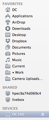

I have a Western Digital 1TB External Hard Drive and I made 2 partitions, one Mac OS Extended Journaled and the other in FAT32.
The drive works perfectly but when I plug it into the iMac, 9 times out of 10 the two partitions appear in the Desktop but only one (FAT32) appears in the sidebar of a Finder window. And it does the same thing on my MacBook Pro.
Here are some screenshots :
Does anyone know why and if it can be fixed? Maybe a reformat would help?

Yeah I've tried it, it works but I have to do it every time I plug my HD.
It's definitely not a major issue but it itches me when for example in a Save dialog I have to look for the drive in the iMac root folder because it's not showing up in the sidebar. 🙂 So maybe someone has an explanation for that.

Oh yes thanks! Done! But that still doesn't fix the Save Dialogs though 🙂

I just did a test with a USB key and made one partition HFS+ and the other FAT32 and ejected then reinserted the key and ejected a couple times. Every time both partitions show on the Desktop and in the Finder sidebar. So dunno what's up with your setup. 😕
I'm on Mavericks 10.9.2.
Yes I have other drives with 2 partitions and they all show up correctly as they should.
I think this is a problem with the drive and maybe the original formatting that went slightly wrong.
