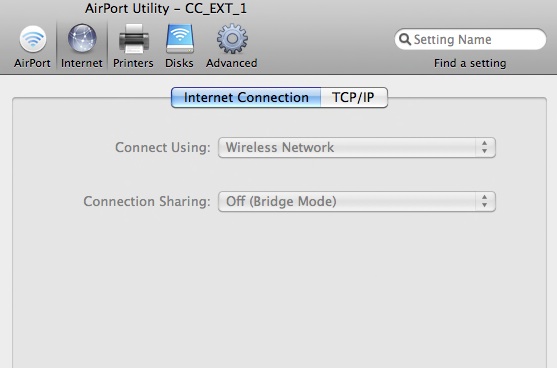

I tried this and the switching seemed clunky... and also it appeared that ONE was trying to overrule the other. For instance, on my iMac it actually stated that there were NO wireless networks in range. And then they were, and then they weren't. When I tried logging into the configuration settings on of them, it timed out (I am sitting in the same room with them).
My settings are as you described... and even in the setup options it states you can extend with "ethernet" (never saying which port to use).

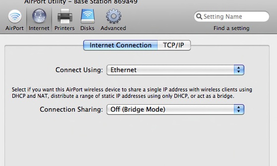

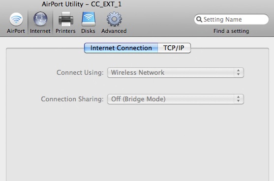

It seems that if you want to extend a wireless network you need to connect to that existing network wirelessly.
I just reset the second AEBS and set it up manually and the second I extend my Internet Connection under the Internet tab grays out and becomes "Connect Using: wireless".
I don't think these AEBS's can be connected via wire.... so bizarre!
(both units brand new this march 2011, and fully firmware upgraded).
I'm sort of puzzled that they wouldn't allow this.... or I am missing some Apple Magic here.

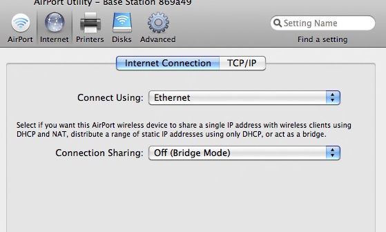

Here's the solution:
1. In AEBS1 setup your wireless network and other DHCP settings as desired. Ensure "Allow this network to be extended" is checked in Airport >> Wireless.
2. In AEBS2 use the setup assistant and:
a. Give it a name and password
b. I want my Airport Extreme to join my current network
c. I want to connect my Airport Extreme to my network using Ethernet to extend my existing wireless network
d. physically connect your AEBS1 LAN 1/2/3 to the WAN port on your AEBS2
e. Select your AEBS1 from the list of devices to connect to...
f. Update...
The part that got me was that when you go back into your second AEBS and look at the wireless settings, it actually will say "Create a Wireless Network". I thought this was wrong and set it to Extend... which is not correct. Using the setup assistant this creates a roaming wireless network and shows up with (imo) a poorly named setting.
