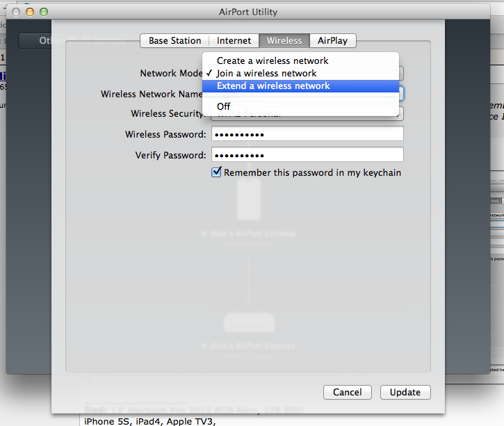

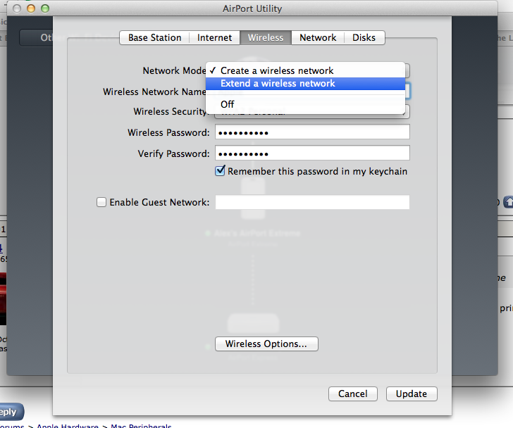

there is a option to EXTEND wireless thats the one I have one connected here at home
