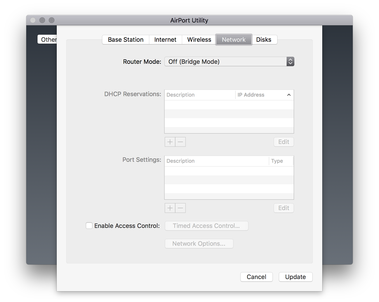

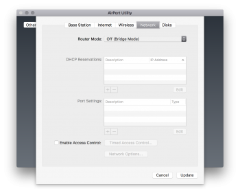

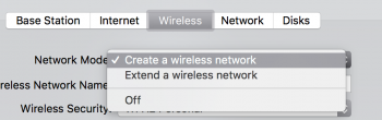

On my Time Capsule (4th generation) it is possible to configure it in Bridge mode to extend a wireless network. If you want to use your new router as a router, and the TC as just an access point w/ Time Machine on it, this is how you would want it configured.
(Note in the pics below I'm in bridge mode and "create a wireless network" because it is my only wireless router, you would want to use "extend a wireless network" to extend your new ISP's wireless router)

[doublepost=1512211002][/doublepost]"Extend a wireless network" (wirelessly) is a proprietary feature that only works with Apple devices.
So no, you can not extend the wireless network of you ISP with a TC (wirelessly).
However, you can :
- connect the TC to the router with an Ethernet cable
- set it up in bridge mode : Airport Utility / Network / Router mode : Off (bridge mode)
- set up both the IPS router AND the TC with the same wireless configuration (same SSID, security and password)

However, you can :
