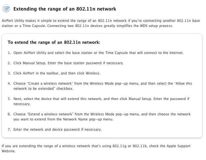

Check this out:
the easiest way is you need both to be N
