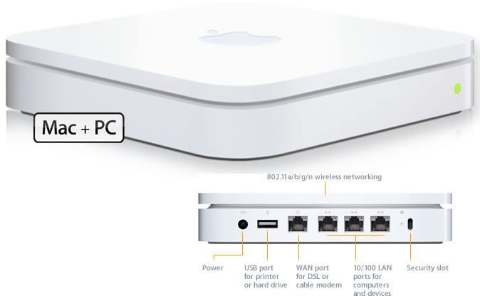

I'm trying to extend my network by using an ethernet cable from time capsule (connected to Fios modem) to airport extreme, but do not know which port (LAN or WAN) to use on the airport extreme.

LAN port.
You don't need to connect it with an Ethernet cable. Just bridge it with your time capsule when you're setting it up. You also don't need to buy an extreme, an express will do just fine since you already have an extreme inside the time capsule.
LAN port.
This:
The ones marked "10/100 LAN.."
(Image from MacLife.)
