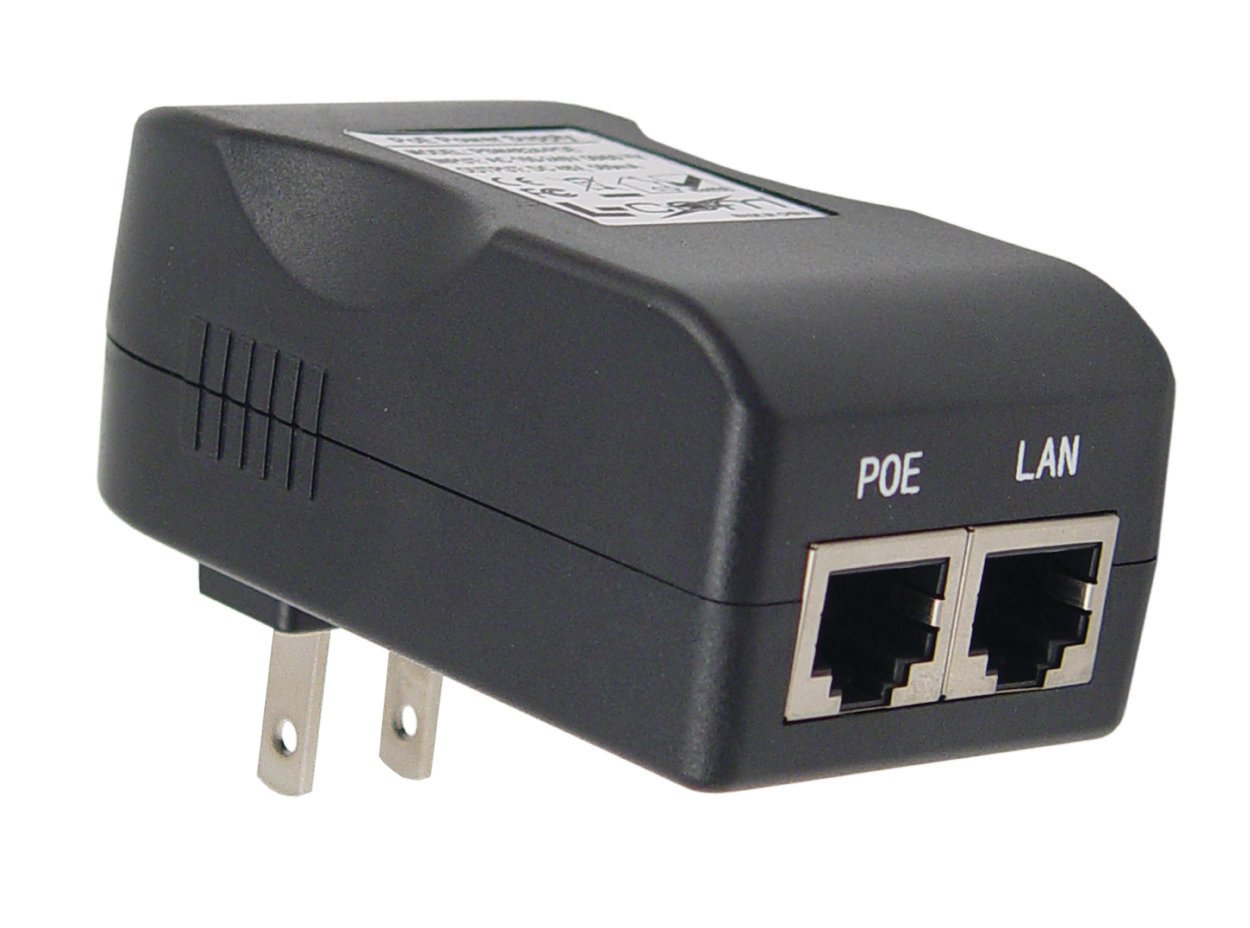

No. A POE device can be run one of two ways, with an injector or off a POE compliant switch. If you have an injector, you would run a data line from your regular router or switch into one end of the injector, and one end into a standard outlet. An injector looks something like this:
Then the Ethernet that comes out of the injector will be powered for a certain distance (usually 100m). The other possibility is to run it off of a POE compliant switch, but that is a waste of money unless you have many POE compliant devices.

No. A POE device can be run one of two ways, with an injector or off a POE compliant switch. If you have an injector, you would run a data line from your regular router or switch into one end of the injector, and one end into a standard outlet. An injector looks something like this: Image Then the Ethernet that comes out of the injector will be powered for a certain distance (usually 100m). The other possibility is to run it off of a POE compliant switch, but that is a waste of money unless you have many POE compliant devices.
