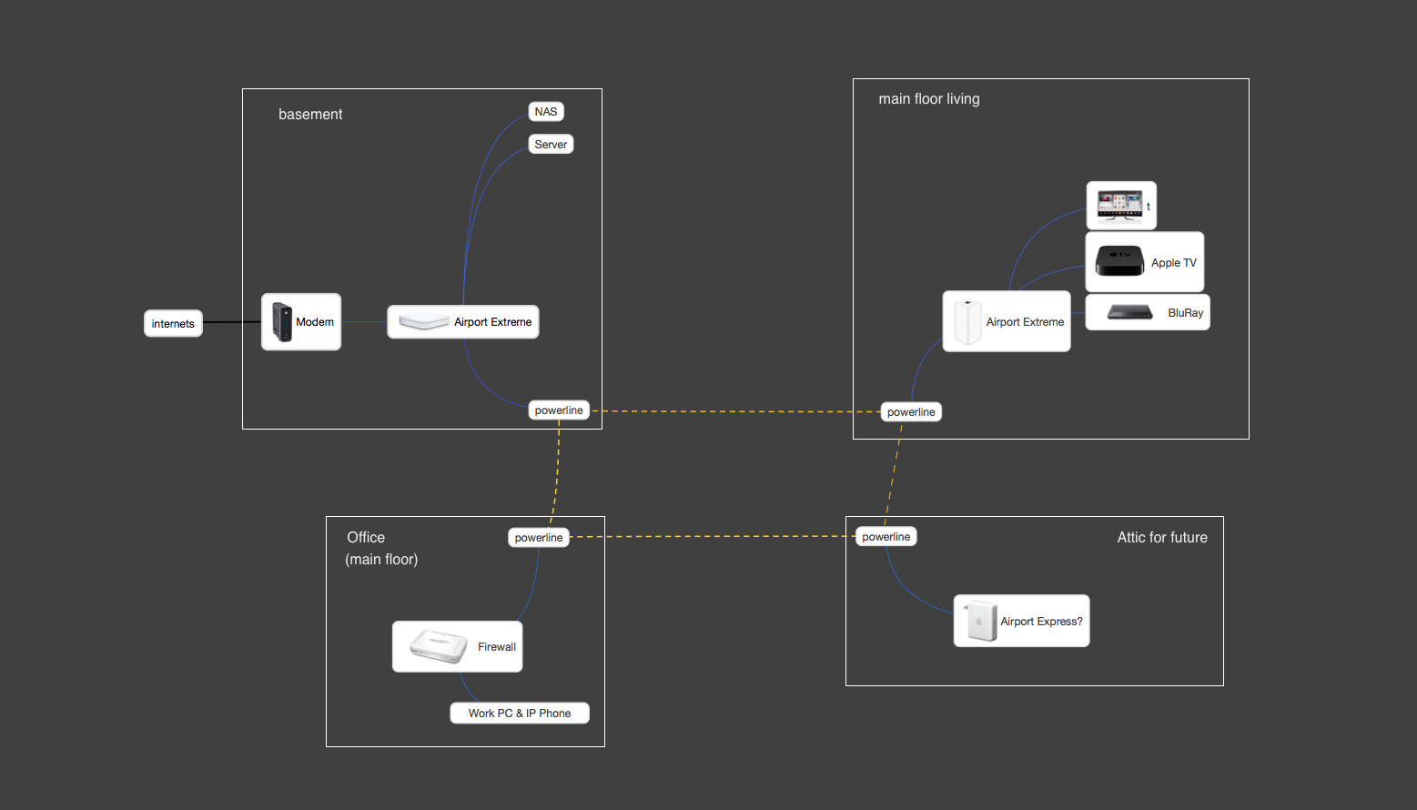

Running cable is an issue because the entire house is finished, and i don't have access to a lot. so Im thinking of having them connect via Powerline Ethernet Adapter. Here is what i'm thinking:
Powerline Adapter: PowerLine AV2 2000 Gigabit Starter KittDHP-701AV
Maybe just use the AirPort AC to broadcast wifi?
Please let me know.
@iJny9956 You can disable wireless on an AirPort and use it as just a router. What is the most central point in your house? We have a center hall colonial so our center point is a closet on the first floor. We can easily run Ethernet to that closet and put our router there if we chose. What are your options?
Personally, I always advise against power line networking. I know people have a lot of luck with them but I prefer standard Ethernet if at all possible. I have seen some houses with rats nests of wiring that is old where power line networking just does not work properly.
That is what I'm doing, using the AC only for wifi broadcast, so far so good. Cant really do a wired setup will have to run wires through three stories. I saw someone post about running wires down laundry shoot. This house has one that is in kind of the center and it isn't being used, definitely a phase 3.
will try the 90 day risk free trial of powerline 😀
It is fine to use a powerline adapter to connect from the modem to the AirPort provided that your ISP's speed is not faster than the adapters can handle.
