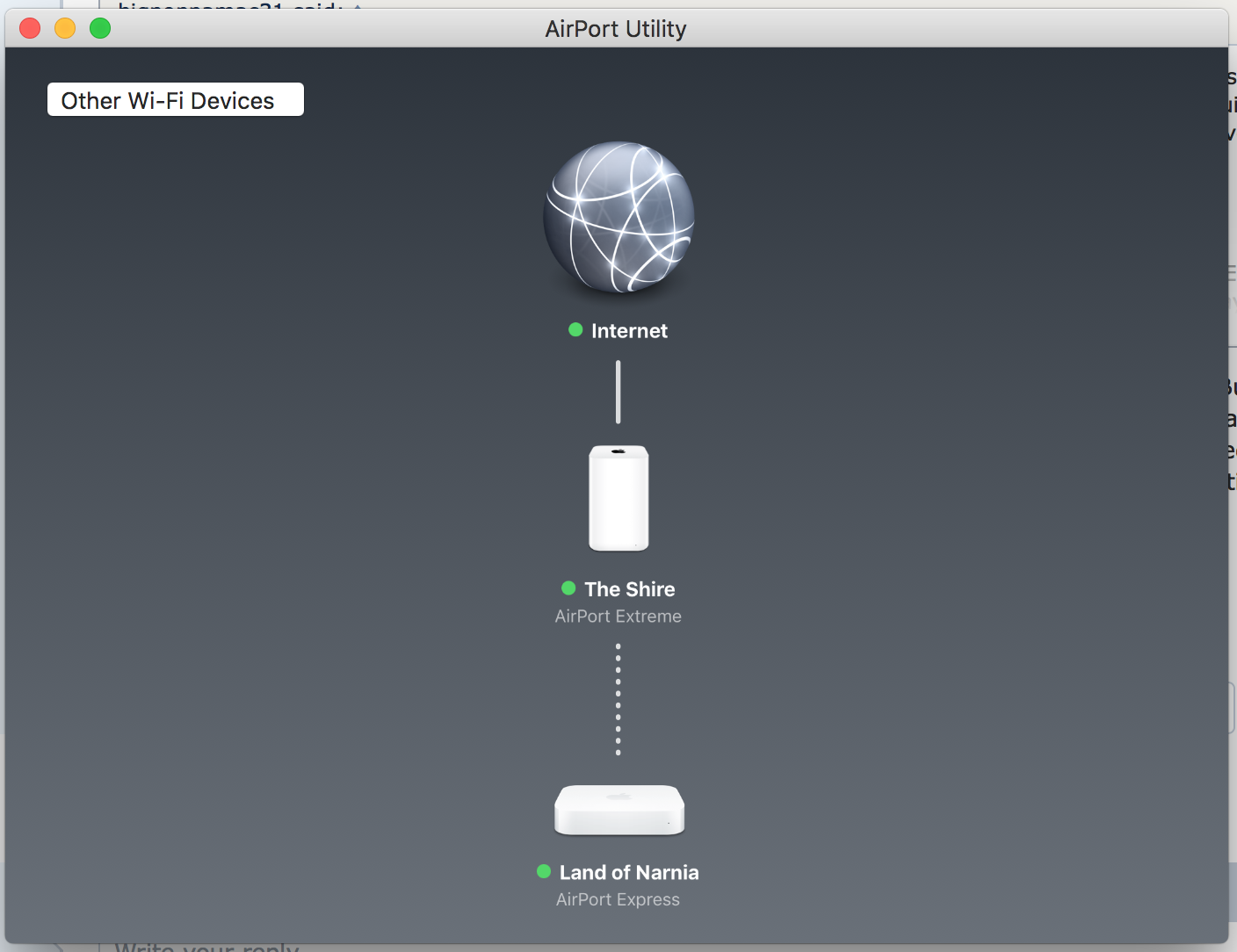

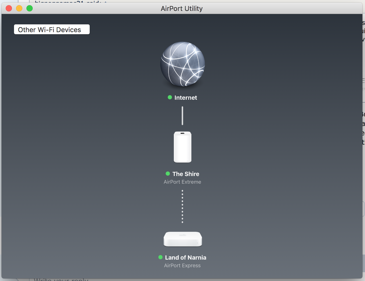

This is what my network looks like. Where do I find the SSID?

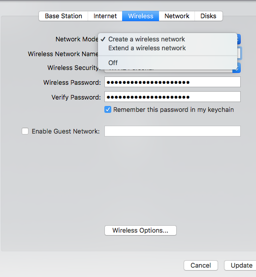

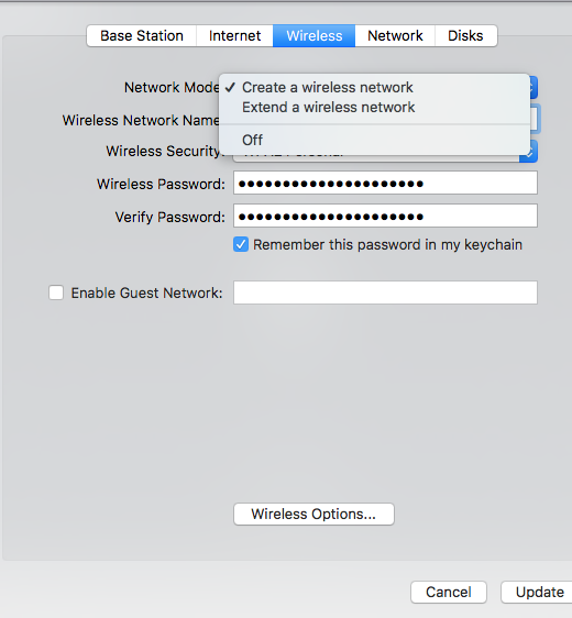

When you click on the express and go to edit the settings. Go to the third pane (wireless). Does it say Create, Join or Extend. I'm not at home so I don't have my extended network, but I am connected to this airport right now.View attachment 706965
My network mode is "extend". Right now my iPhone and Mac are connected via my Express which is in my bedroom. The Apple TV in the living room as well as my dad's iPhone and iPad are connected to the Extreme which is in the living room.
Thats very weird. It is possible the two units are too far away from each other, so the iPhone and iPad are seeing the extreme has a strong signal. I'm not really sure. I have never experienced that. Only thing I can suggest is restore the express to factory and reset it up as extending again. Maybe something went wrong. But with my 2 expresses and 1 extreme, it will auto switch once I get closer to another access point. You could try moving them close before resetting it up. That could trigger it. I have each express about 20-30 feet from the extreme, but with very limited walls in-between.
Well my dad's iPhone and iPad are close to the Extreme in the living room which is why they're seeing it and not the Express. That's what I want. My iPhone, Mac and AV receiver are all in my bedroom where the Express is and they are seeing the Express. That's also what I want. That to me makes sense but perhaps I'm doing it wrong. When I go into my AV receiver settings I see both routers which both have the same name. Kinda confusing.
That doesn't sound right. It shouldn't see both routers. My devices only see my one network as "Rollin". Even when I open the application I posted above, it will see all three routers, but they are all named "Rollin". Thats how it gets it automatic connection. It just gravitates towards the strongest signal, even though they are all the same network.
Something is off, but if the devices are connecting to the router that you want it to, I wouldn't mess with it because it may change things. I just don't understand why the AV is seeing both units.
