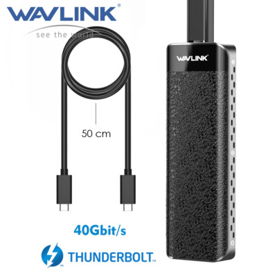

I have it permanently connected to my Mac Mini M4, used it every day for the last 3 months and no problems so far.
Other people in the thread linked above had it for longer and can provide a more accurate reliability status.
Thank you very much for reply. I will buy one then.
