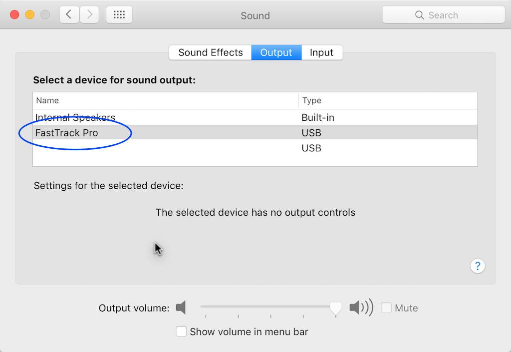

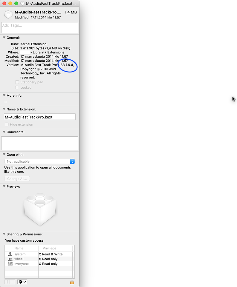

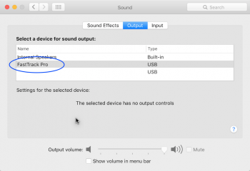

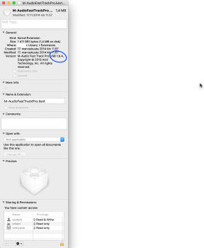

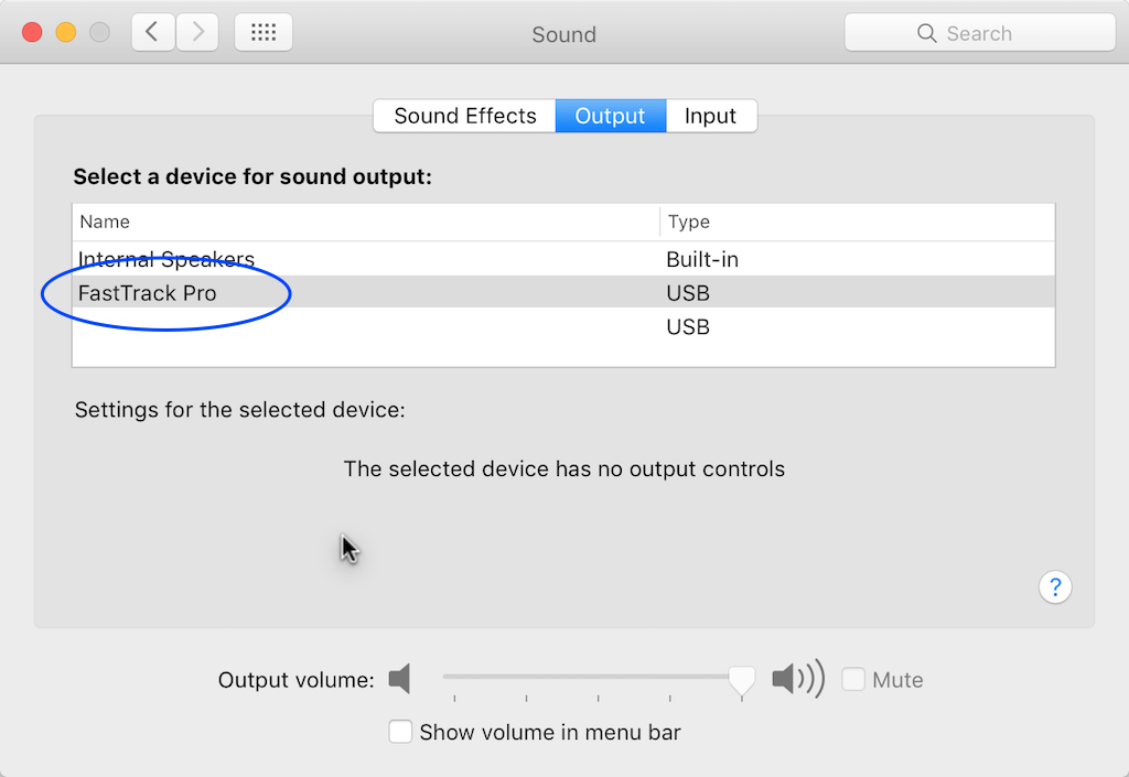

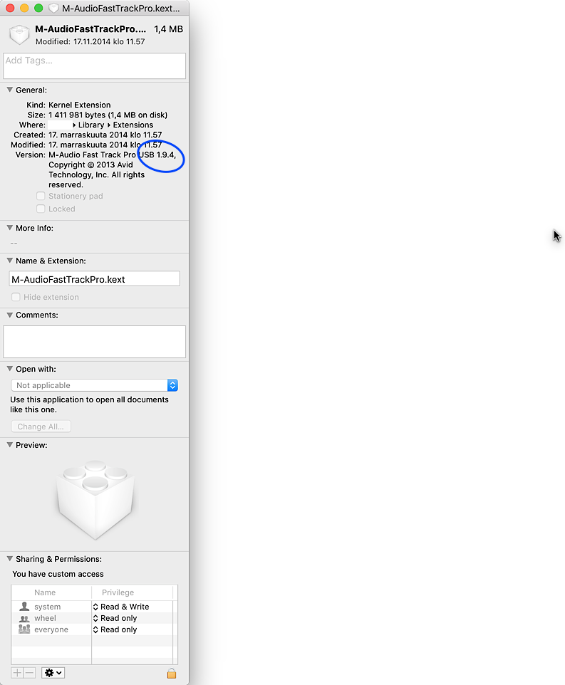

I found a thread where someone had gotten Fast Track Pro to work with El Capitan by copying the M-Audio kext from /System/Library/Extensions to /Library/Extensions, fixing permissions, then rebooting. Tried it out and it didn't initially work, but somehow the next day "FastTrack Pro" had appeared as an input/output device overnight. I did delete the kext from /System/Library/Extensions. The Preference Panel says "driver not installed" — yet I have sound. Try it out. http://duc.avid.com/showpost.php?p=2299331&postcount=18
I have my device showing up as an output device, but whenever I try to play audio, the application doesnt play.
