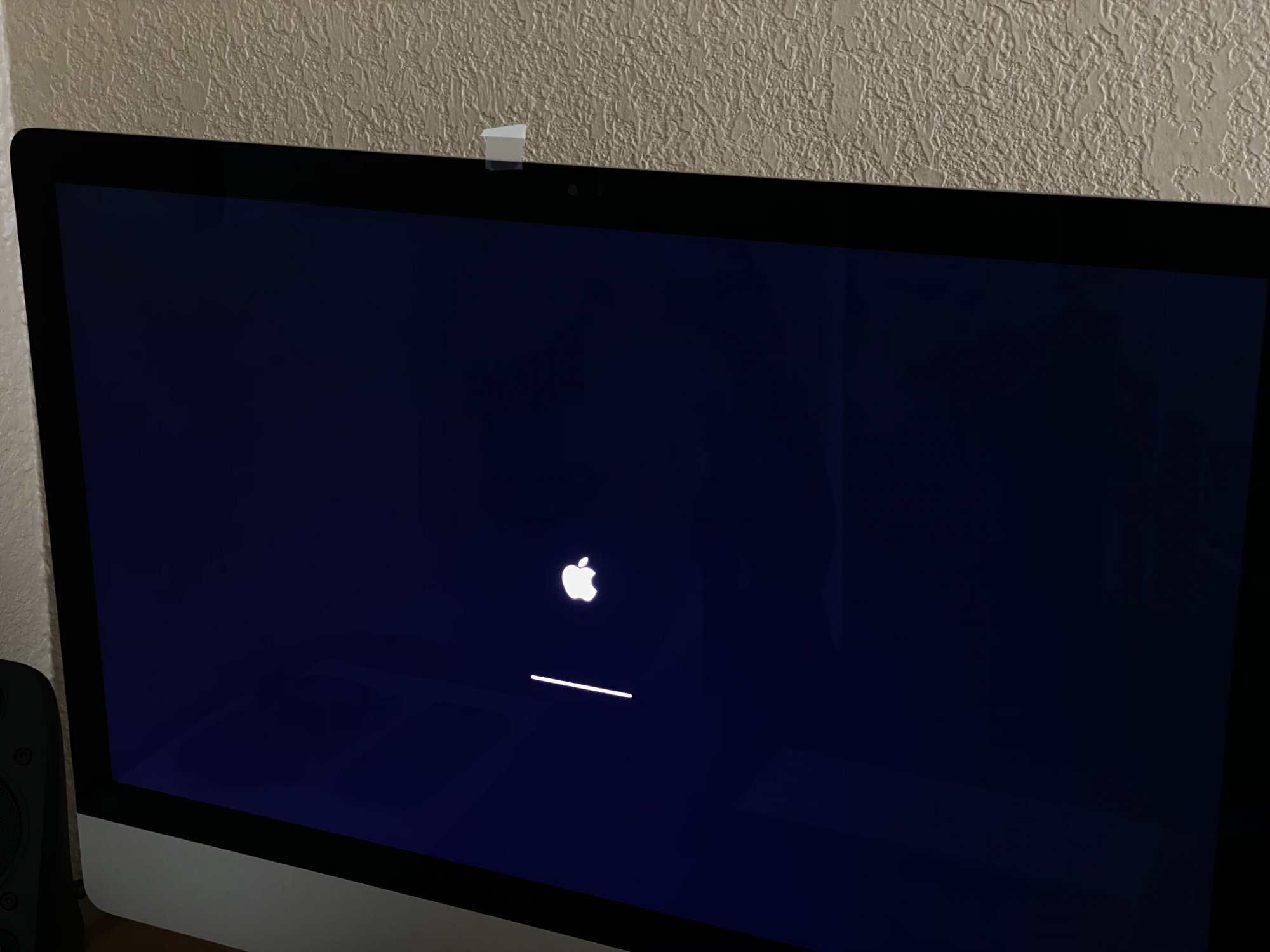

After reading this thread (https://forums.macrumors.com/threads/2017-imac-27-external-ssd-as-boot-drive.2096033/) I was inspired to boot my slow iMac from an external SSD. I bought a Samsung 860 EVO 2TB and cloned my OS to it. When I try to boot from it the startup screen loads completely but never advances to the desktop, it just hangs there for hours. Initially, I thought the cloned OS might be corrupt so I ran a fix in Disk Utility which repaired some errors and gave me the green checkmark. It still would not advance to the desktop. Decided to try a a different USB-C cable and voila, loaded right up. The OS and files were all there but the speed was NOT. My friend's cable was an Apple USB-C charging cable with only USB 2.0 speed, not a viable solution to get the speed improvement I am after. I bought a second USB-C cord thinking the one that came with my hard drive enclosure must be junk but once again the start up screen just hangs with the new one. Do I need an Apple brand Thunderbolt cord to achieve startup and desired speed? I realize the speed of thunderbolt will be bottlenecked by the SATA drive. Could this be a power issue? Any advice is appreciated!

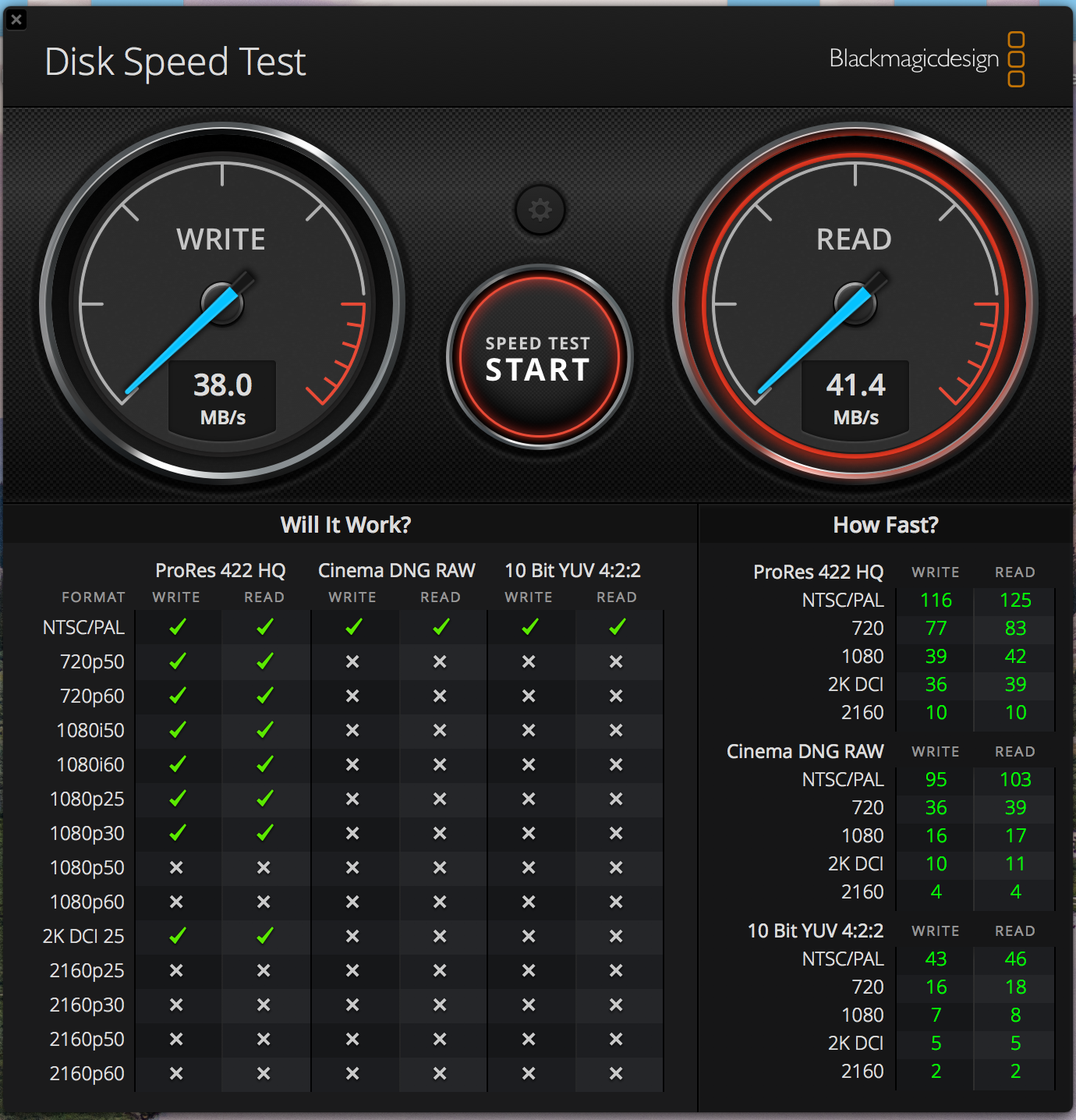

Thanks for your reply, Fishrrman. Your posts in the thread I linked to above were really helpful to understand the process up to here.

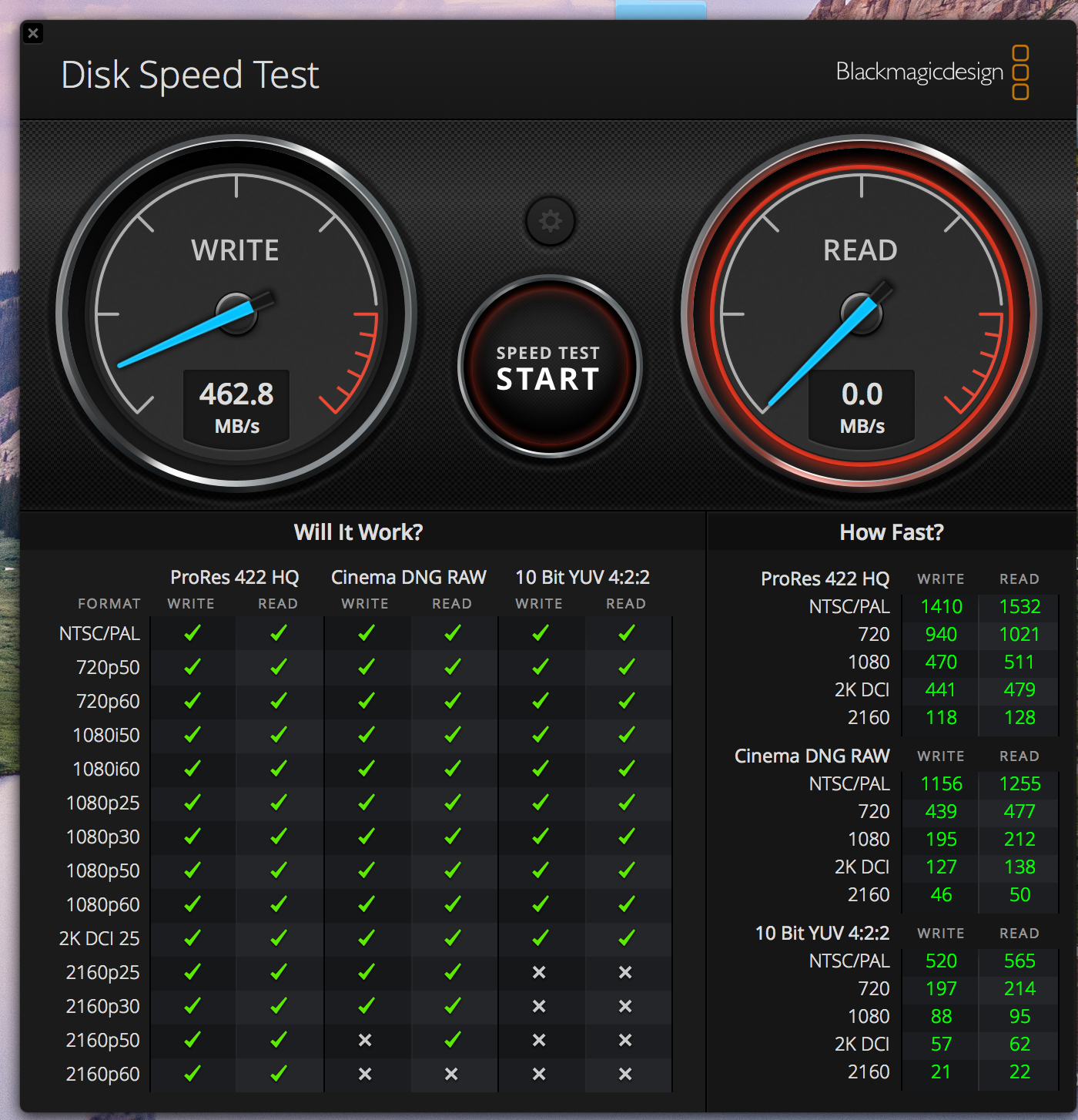

Here's where we are so far using the amazon basics cord:
Something is very wrong if all you're getting are the numbers in reply 3 above.
I'd suggest you order ANOTHER 2.5" enclosure.
MAKE SURE it's advertised to be "USB3 with UASP support".

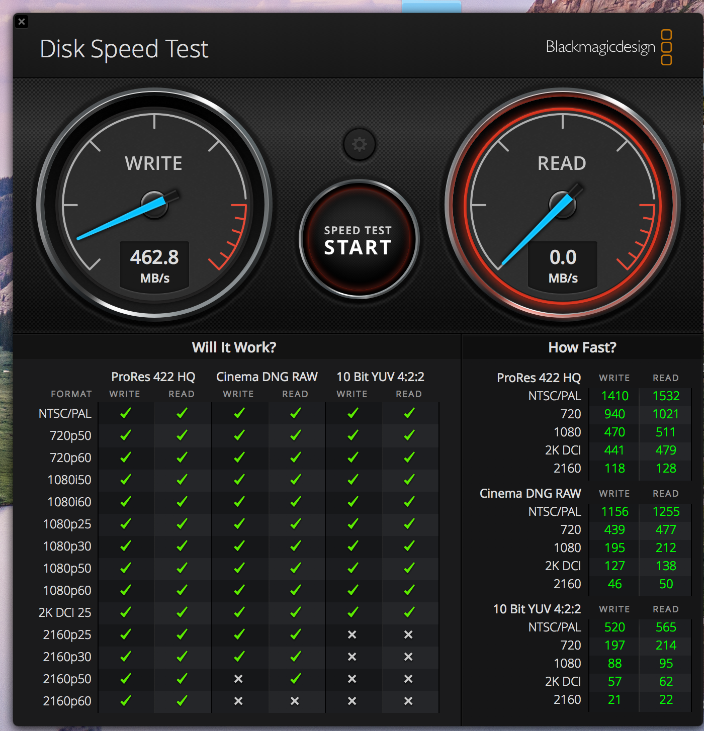

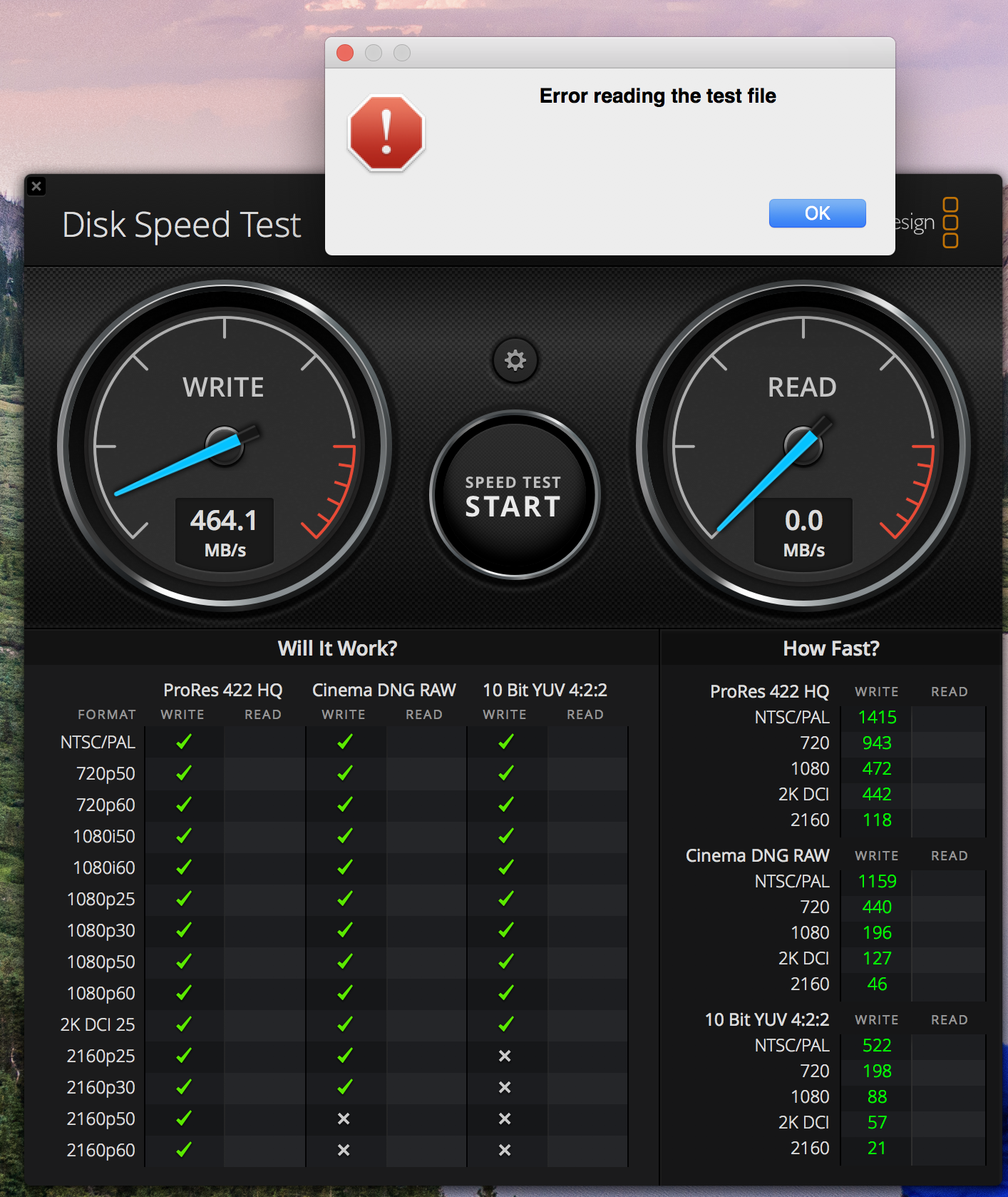

Thanks for your suggestion. I've ordered another enclosure with USB-C to USB-C cord. And contacted the original enclosure seller and they are sending me a replacement.

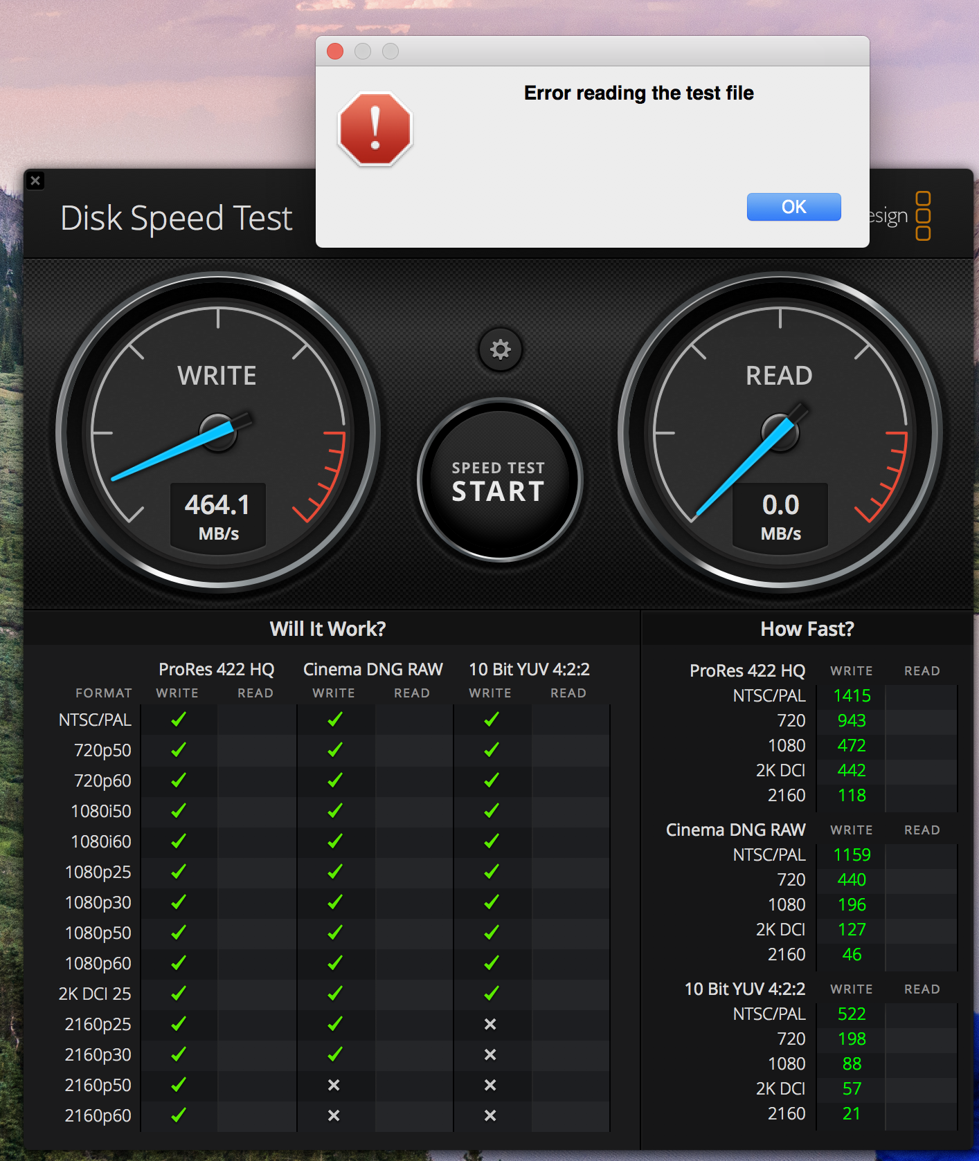

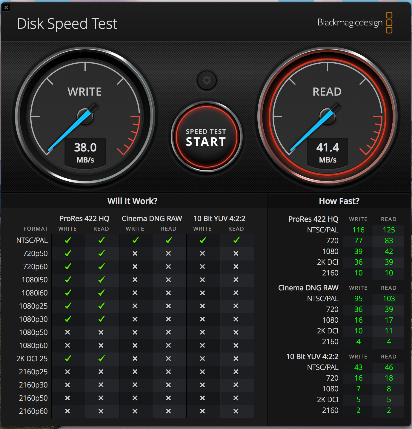

I tried it again with the original cord and got these numbers and then the program froze, spinning wheel and then the drive was ejected. Very bizarre.
