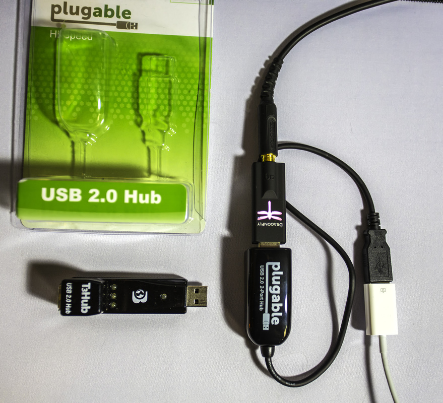

The setup I use for portability, when I want the best sound, is an iPad Air 2 (or iPhone 6 Plus), the lightning to USB connector, a Plugable USB hub (it tricks the Air 2 or 6 Plus into thinking it is getting power), and a Dragonfly Dac. While it does require the Plugable, the Dragonfly is very small, so the setup is less cumbersome than some of the battery powered setups. However, you can't charge the iPad/iPhone while using this setup, so you need to plan ahead. It has never been a problem for me with the iPad since I charge it every night, but it is something to consider.
I have an article and video here. You can also look at some of the other pages if you are curious about the APE/DAC setups.
Here is a pic of the setup (Note: there is also a T3hub in this picture, but it is for older setups like the 4S that do not work with the Plugable):
FYI I have no idea if it will work with the iPad Mini since I don't own one to test.
