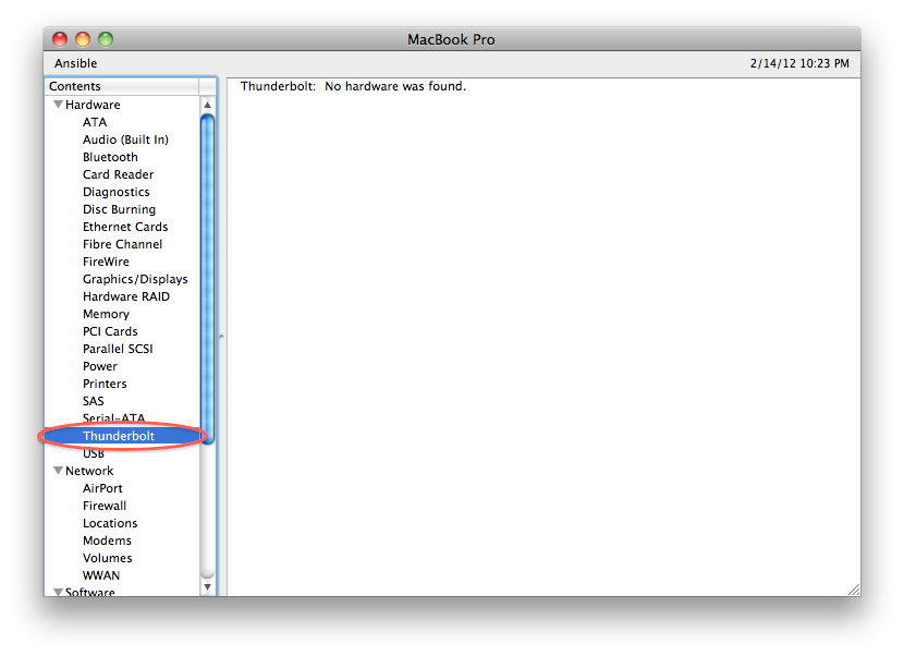

Before you do that, could you go to your System Profiler (Apple > About this Mac > More Info) and tell me what version of Thunderbolt is listed under Hardware > Thunderbolt? As far as I can tell the latest firmware version for Thunderbolt is 1.1.

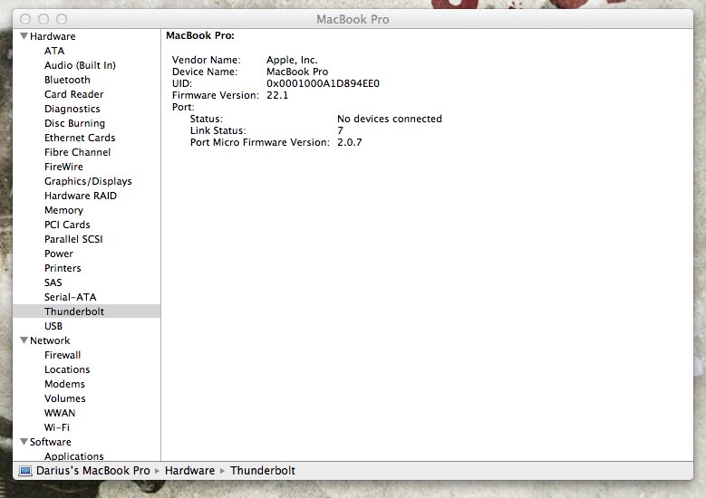

could it be 22.1?
MacBook Pro:
Vendor Name: Apple, Inc.
Device Name: MacBook Pro
UID: 0x0001000A1D894EE0
Firmware Version: 22.1
Port:
Status: No devices connected
Link Status: 7
Port Micro Firmware Version: 2.0.7

And the information you provided about your thunderbolt chipset is... interesting. Just so we're on the same page, this is the page I want you to check;
(I don't have any Thunderbolt hardware because I'm using an early 2010 MBP, so I can't test this issue myself.)

Yep, same page. As i said my adaptor is fake, maybe thats what causes this. However it worked on different display with cable it came with.
