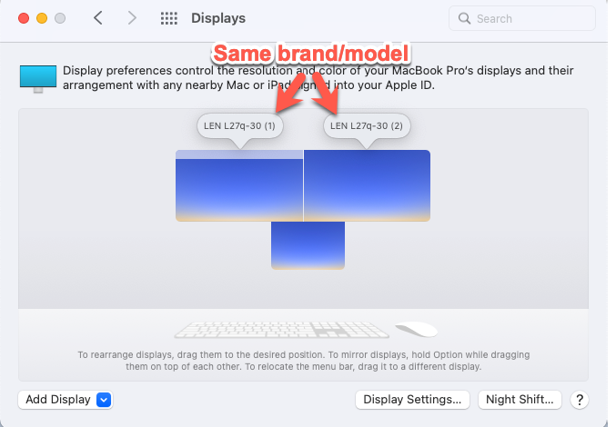

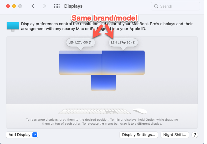

I am running 14" MBP with two external displays and the monitors will not keep their position to the left/right every time I wake from sleep or plug back in. The monitors are arranged above my MacBook Pro (see below), with the monitor on the left connected via a USB-C dock and hte monitor on the right via HDMI.
After waking the computer, the monitor on my left will be on the right and vice versa so I have to go into the display settings and drag-and-drop them back into place.
The only thing I can think of is that each monitor is the same brand/model and perhaps that is causing an issue. I'm not sure if this is an OS Monterey or hardware issue. I've tried ensuring I plug-in the computer in the same order or make different monitors (including the MBP display) as the 'primary' monitor, but nothing seems to work. I have not tested using a different USB C dock solution or ocnnected directly to the left monitor via a USB-C-to-HDMI adapter in case the dock is causing the issue, but that doesn't really make sense to me.
Is there a way to perhaps adjust the names or behavior of the displays to trick the OS into remembering one should always be on the left?

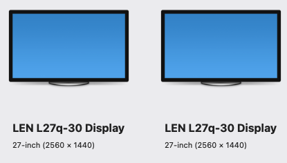

My exteneral displays - same model.
I appreciate any insight or help!

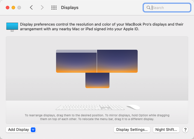

Bumping this because it is still happening. I am not sure if anyone else is experiencing it, can't determine if related to new hardware (14" MBP) or an OS Monterey issue.
I'll drag-and-drop in the Display settings or even flip-flop the connections and it keeps thinking my (1) display is on the right and my (2) is on the left (until I drag back into the correct place)
After swapping into the correct order.

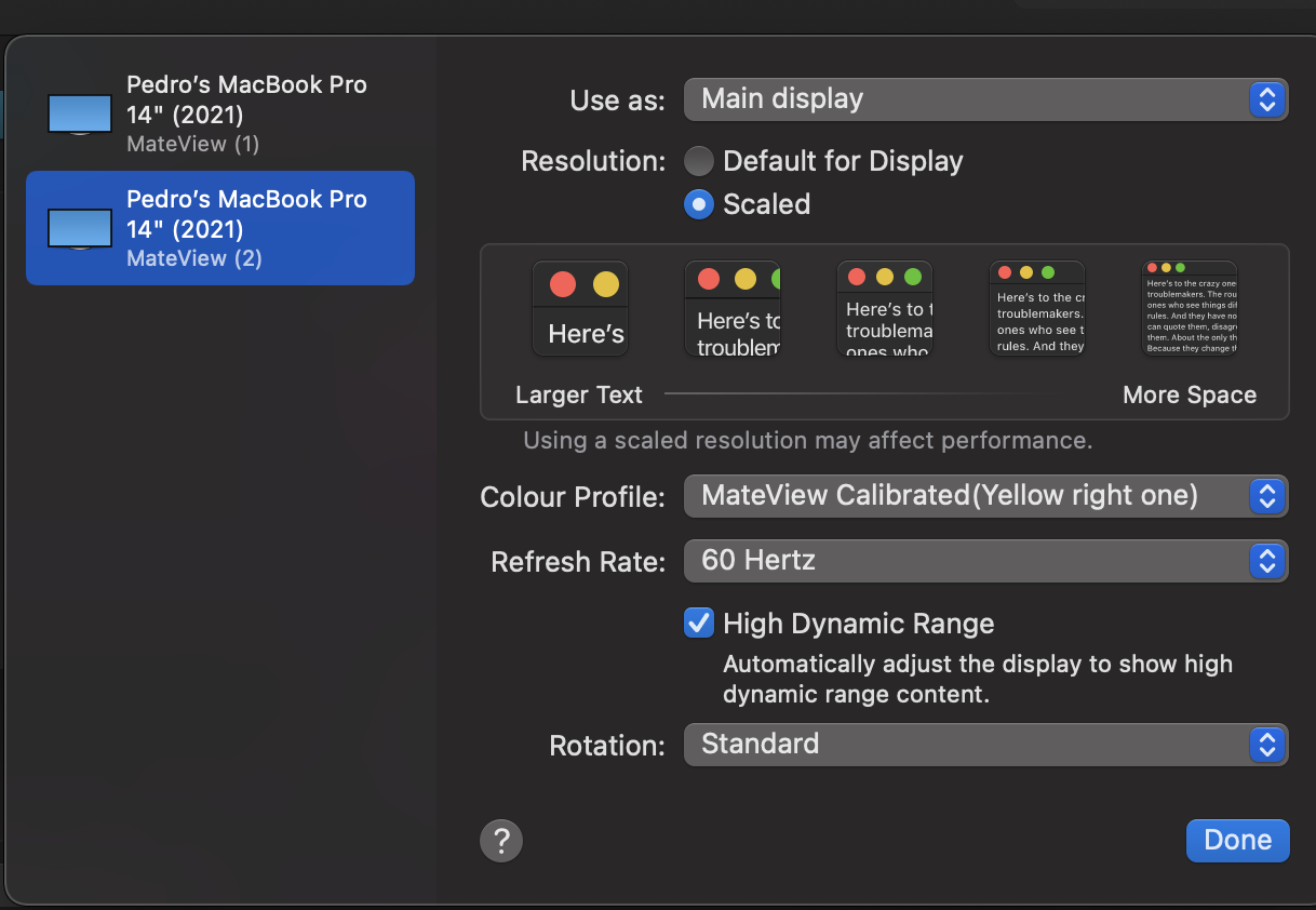

14 inch MBP M1 Pro, 2 x HUAWEI MateView 28.2 4K Displays, both connected over USB-C. Often swap arrangement on their own from left to right, and have to be manually put back in order. HDR toggles on and off on its own. Sometimes the wallpaper changes.
V annoying.
Come on Apple, sort this out.

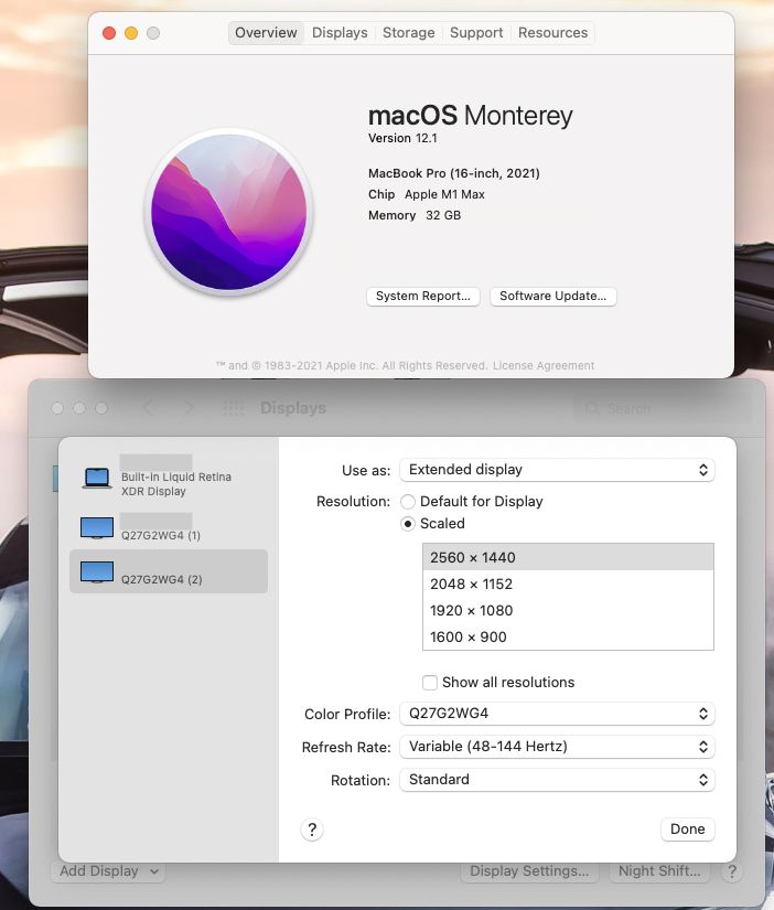

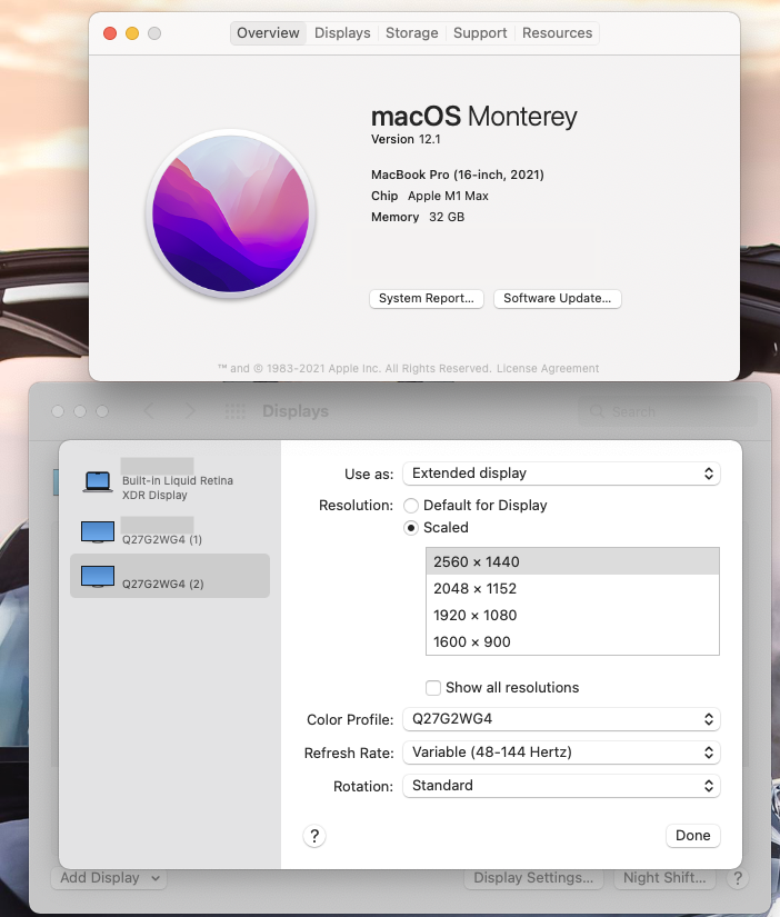

Similar issue here - MacBook Pro 16" M1 Max 32 GB, connected via USB-C to DP cables (swapped 4) to x2 AOC Q27G2U's
Every time I reboot/sleep the refresh rate changes to the default Adaptive Sync, which causes both of the monitors to flicker like crazy!
Even after sleep and wake up cycle of the MacBook the settings reset, monitors flicker like crazy, until I go in and change to 144 Hz Only...
The arrangement of the monitors is saved however...
Had none such issues with the same setup on my Intel 2017 MacBook Pro running the same version of Monterey.
Hope Apple or Someone else finds a workaround this madness...
