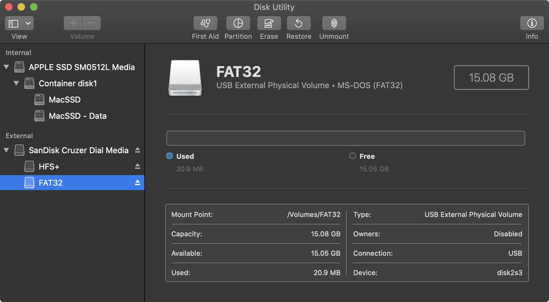

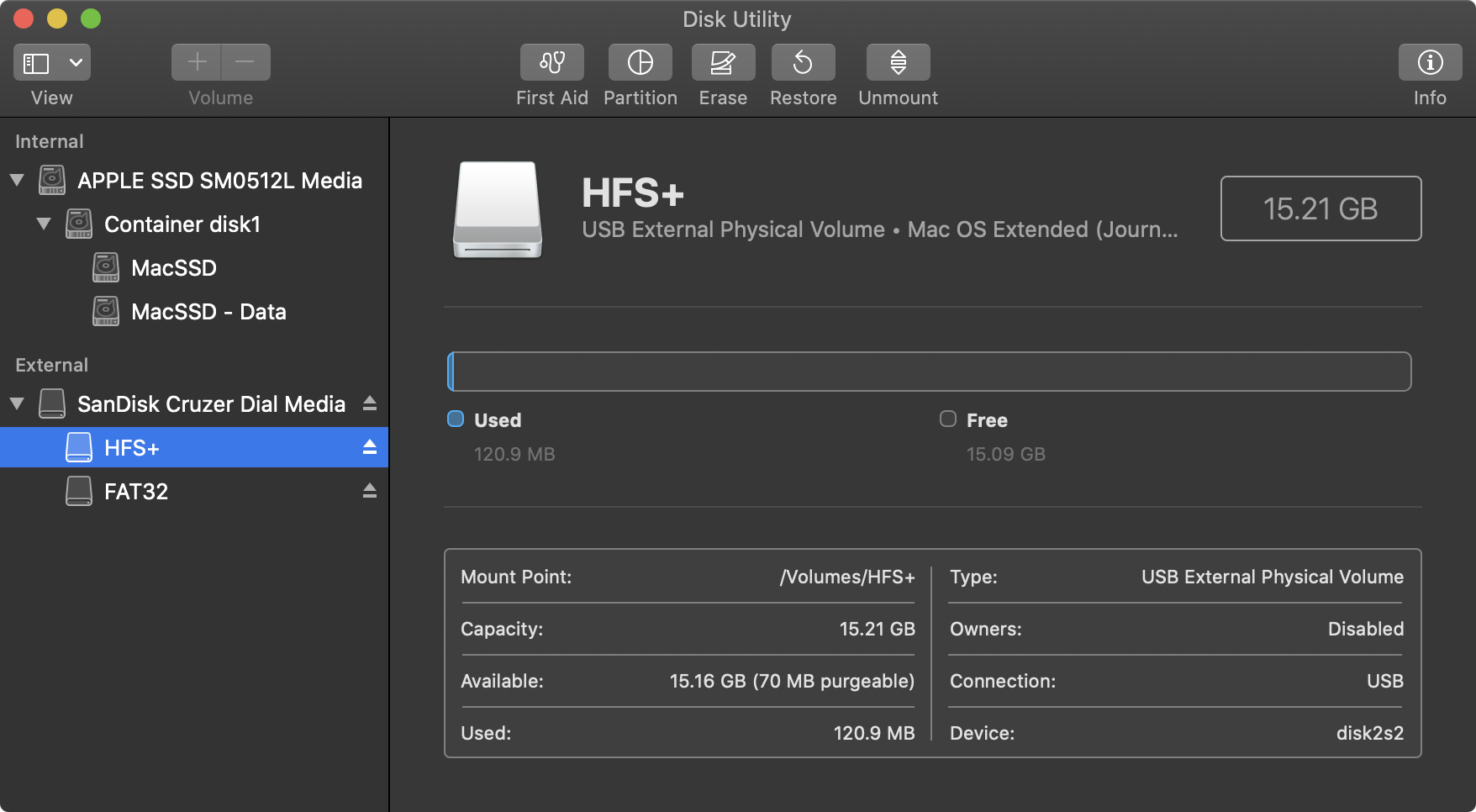

Try it yourself on another drive...even a small flash drive.
1. Erase the entire drive, format it HFS+
2. Add a partition, format it FAT32 (MSDOS-32)
3. Test, test, test!
When I try this with ExFAT, it does not work (always an error). But with FAT32 (MS-DOS 32), the partition is created and seems stable and fine. Both mount and appear as separate drives on the desktop (as partitions would be expected to do).
Will there be any issues? Dunno. I would also test both partitions a good long while be trusting either to be usefully reliable.
