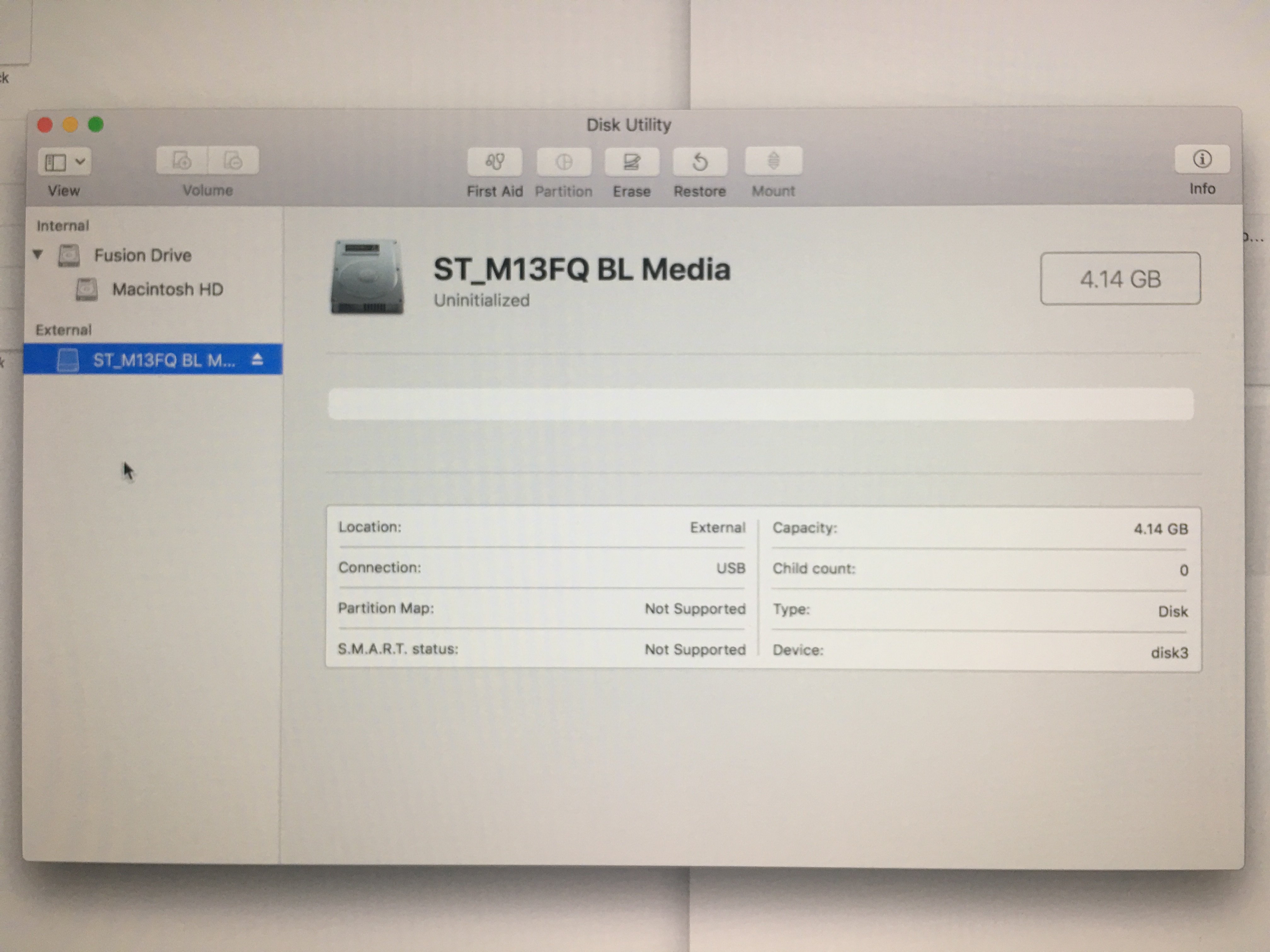

I have searched the net but keep coming up lost. I had a older Mac get destroyed in a car accident as it was being hauled. Was able to save the hard drive but cannot seem to pull any info from it. I am running High Sierra 10.13.5 on my current Mac. When I try to plug in the older hard drive I keep getting an error. When I look at the stats it says its uninitialized. I am plugging from an external hard drive shell to my computer via USB. When I click on finder it does not show under my devices.

Maybe the hard drive failed as a result of that crash. Dropping a hard drive is none of the easiest ways to kill it. Does the external drive appear under Disk Utility
This is what I see.
Not enough information to determine anything other than "there's something wrong". Odds are that you'll never get it to mount. However, I have had a drive behave like this over and over...then suddenly it mounts...but subsequently it goes back to broken.
A file recovery app may or may not pull up anything. A disk recovery service likely could get data off of it. Either way, the results can be ugly. Files can lose their names so you just end up with a whole lot of files with numbers as names and you have to open each one of them to figure out what it is.
