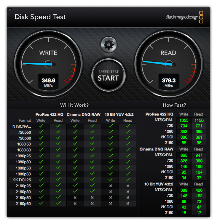

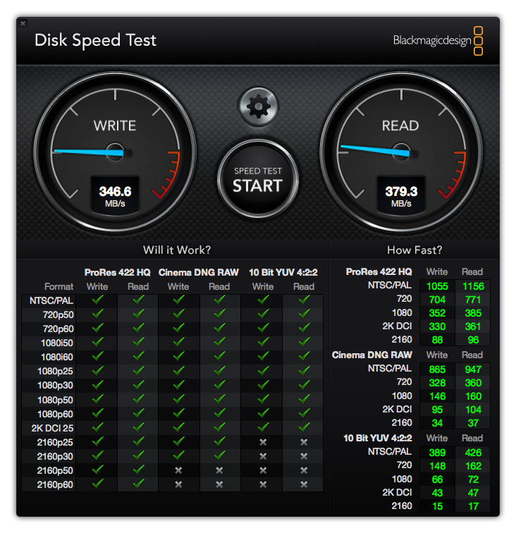

Just for comparison, I tested my Micron (Crucial) M500 1TB SSD which is in a ThunderBay 4 connected to a 2015 5K iMac with internal 1TB SSD only. The BlackMagicDesigns speeds are shown below. If the OP happens to have a similar brand SSD, I could move mine to a ThunderBay 4 Mini to verify that I get similar results. My Thunderbay 4 also has a couple of 3.5" hard disks enclosed with the SSD.
