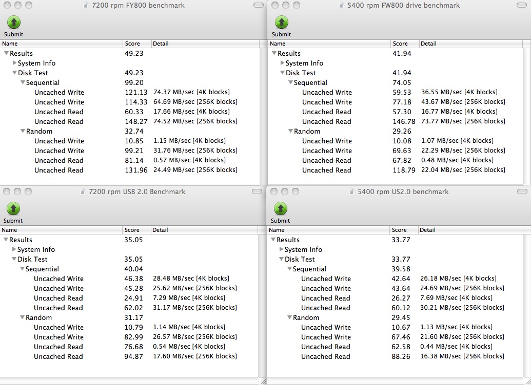

Folks,
I recently picked up a couple of external drives, and decided to benchmark them to determine whether the interface and/or drive type made much of a difference. For those that don't want to read the details, here's the bottom line:
If you're going to splurge on a FW800 interface, it's well worth fitting this with a 7200 rpm drive to maximize performance. Uncached sequential writes over FW800 were twice as fast on the 7200 rpm drive compared to the 5400 rpm. FW800 is a marked improvement over USB 2.0 as well.
Full results are below.
For background, when shopping for drives, I was interested in using the FW800 interface on the MBPs, for the simple reason it's rated almost twice as fast as USB 2.0. Some of the drives I was shopping for included 7200 rpm drives. My first thought was this was silly, since the interface limited the throughput to far-below the limits a 5400 rpm drive could produce, so why bother upgrading to 7200 rpm?
Well, it turns out it does make a difference. I've got both a FW800 enclosure (G Drive Mini) and a USB 2.0 interface (Nexstar TX) as well as a 320GB 7200 rpm drive (Hitachi) and a 640GB 5400 rpm drive (Western Digital).
So, I benchmarked both drives using both interfaces. Some interesting results! Turns out, the 7200 rpm drive does in fact dramatically improve performance in the FW800 interface. For sequential operations, Firewire has a dramatic improvement over USB 2.0; for random read/writes, drive speed seems to be a more important factor. And for large files, the combination of Firewire and 7200 rpm gives a pretty impressive throughput of almost 75MB/s. Full results are below. Enjoy.
Note that the drive and interface are noted in the title bar for each drive.

The difference between 7200RPM and 5400RPM on FW800 should not be that big, something is off with this test.... What type of disks have you used?
+1
can anyone confirm this. I thought that both the FIREWIRE capped the 7200RPM drives at the SAME exact performance of the 5400RPM(which firewire800 lets it work at max) so the difference should be very little
5400 drive is the Western Digital Blue; 7200 Drive is the Hitachi.
I didn't think there'd be much difference, either, but hey, nothing beats data and testing compared to theory.
Yeah well, I've seen plenty of tests showing 2.5" 5400 RPM drives to be just as fast and in some cases even faster than some 7200 RPM drives.
Your test only shows the difference between your two drives, add some more into it if you want to actually have some useful data.
What's the real world transfer speed with the different drives/connections? Copy a large (several GB) file and see how long it takes (and take a look at the Disk Activity window in Activity Monitor).
I didn't even bother looking at your Geekbench scores. Synthetic benchmarks are meaningless.
I can transfer at a steady 28MB/s with USB2.0 and a steady 39MB/s with FW400 on a NewerTech Ministack 2 (my Ministack 3 with FW800 is at home)
Do your own tests if you don't like mine. Honestly, I don't care if you think these results are valuable or not. I posted them as a public service here, I documented my methods and both the drives and interfaces used, and I had 2 objectives to answer: does either the drive speed or the interface type make a difference in transfer speeds using an external enclosure.
My initial assumption was interface did make a difference (I would have assumed FW800 was faster than USB 2.0), and that drive speed would NOT make a difference (as the interface was much slower than the drive). I found - through a documented, controlled test - that drive speed did make difference in addition to interface type. This was surprising to me.
I frankly don't care if you tie a string and 2 tin cans together to test interface speeds. Knock yourself out.
Gee. Maybe you should have looked at the benchmarks. My 5400 rpm tests showed an average sequential write speed of 25 MB/s with USB 2.0 and 39 MB/s with FW800. Coincidence? Yeah. Meaningless results. You were right. And, I do wonder what difference FW400 vs. 800 introduces...
It was a matter of time before someone said "XBench is useless" lol ...
Might be useless looking at the number itself, but what matters, is the relative increase in the numbers.
I have two 1TB Samsung 7200 RMP drives, which can reach ~35MB/sec on USB, ~77MB/sec on FW800, and >120MB/sec on eSATA. Drive speed depends on data density, so it's possible for a high density 5400RPM drive to still max out FW800. In fact, according to reviews, the 1TB Samsung ecogreen (5400RPM) drive can reach 85MB/sec. As expected, the 1.5TB model is slightly faster and can reach ~100MB/sec.
Of course, hard drives use relatively little power compared to the rest of the system, so I don't see any reason to buy a 25% slower drive to save a watt or two when my desktop PC is using ~200 watts.
I think it's always been understood that FW800>>>USB 2.0 ... but nice to see more proof I suppose. Hell, even FW400=>=USB 2.0. And FW doesn't hog CPU usage.

I don't about these benchmarks but my FW 800 WD 2TB drive result is:
Disk Test 44.32
Sequential
Write 60.82 MB [4K]
Write 62.18 MB [256K]
Read 16.14 MB [4K]
Read 72.21 MB [256K]
