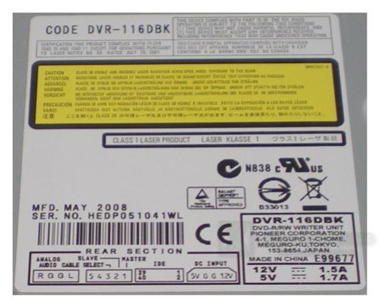

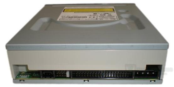

Are the jumpers set to Master?
Is the little white knob on the left of the IDE interface in the same position, as on the following image?
Does it even power up and can the tray be manually ejected?
Yes, set to master and powers up fine, IDE cable keyed towards power and can be ejected. Have tried it with no jumpers on as well.
