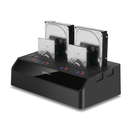

Sharkoon SATA QuickPort Duo v.2 (2x bays, SATA, USB 2)
Sharkoon SATA quickport Quattro (4x bays, SATA/USB 3)

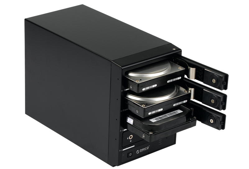

Orico 8648rusi3 (obsolete) (4x bays, SATA/USB 3/Firewire 400 & 800)
Orico 9849rusi3 (obsolete) (4x bays, SATA/USB 3/Firewire 400 & 800)
Orico 9648rusi3 (replaces above 9849 model) (4x bays, SATA/USB 3/Firewire 400 & 800) -not sure what specs differ except the rack ears and openings for the front LEDs look slightly different.

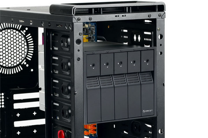

Orico 6204ss (for mounting in a 5.25" drive space -I assume PC type enclosures with power supplies can be bought for this purpose) (4x bays, SATA)
Orico 6205ss (similar to the above, but for an additional drive) (5x bays, SATA)

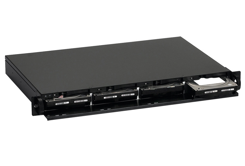

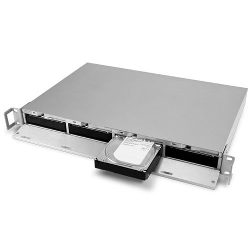

OWC Mercury Rack Pro (looks very similar to the two 19" rack units from Orico, doesn't it?) (4x bays, SATA/USB 3/Firewire 400 & 800)
The 8648rusi3 (obsolete but still available many places online as far as I can tell) seems to be a good choice, as do the Orico and OWC 19" rack units (but at a price). I don't know enough about how the 5.25" Orico devices connect to the Mac -if they're simply mechanical units meaning they can use any SATA interface inside a DIY 5.25" PC enclosure, allowing for simple upgrading (of the SATA interface) if newer, larger SATA hard drives appear in the next few year that no longer work with the current SATA interface inside the PC enclosure or not.
The drive docks would of course be a simpler, cheaper alternative to all the above but none of them support Firewire and they're probably less sturdy/more fragile and lack cooling fans (except for the 4 bay Sharkoon above).

I've been looking closer at the so called SATA backplanes such as the Orico 6204ss. They seem to be more or less mechanical devices (connectors for the drives etc.) with SATA connectors going to the interface of your own choice if I'm not mistaken. I'm guessing that apart from installing it in a suitable PC case with a power supply I'd need a SATA 4-port multiplier with (for compatibility with other Macs than my Mac Pro) a Firewire bridge and possibly also a USB 3 bridge. I've even seen that some of those port multiplier/bridge boards have PCIe type brackets which mount to the back of the PC case, so that's nice. The eSATA connector on the back would then be connected to my Mac Pro's SATA PCIe card with a cable. Can someone conform if this is correct?
If so, this would probably be the most "future proof" and cost effective solution even though I'd have to spend some time DIYing it. If the multiplier/bridge board becomes obsolete (if larger SATA hard drives are introducted making it incompatible) I could exchange it for a different board. I see they cost around US$ 70 to 130, so that's not too bad compared to buying a brand new enclosure.
