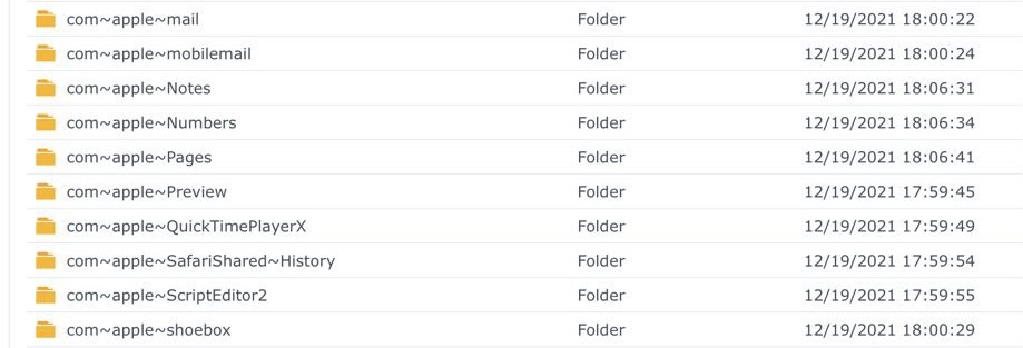

I’ve had terrible trouble with TM recently even with a wired external HDD, so I have decided to go with Synology Drive. It allows much more granular control over the process. I have it backing up key folders, but it wont restore a computer like TM does. The other disadvantage is that it doesnt upload iCloud folders and files cleanly to NAS (see photo).
