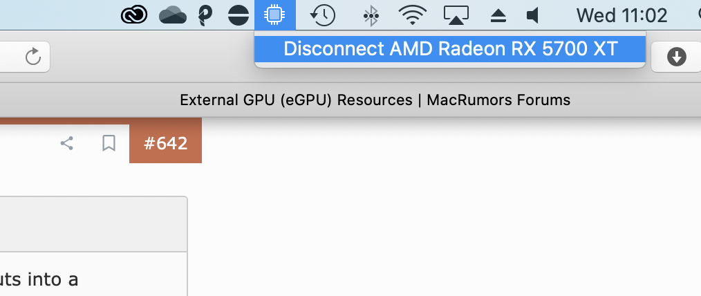

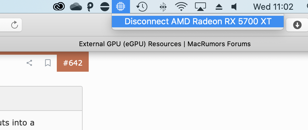

5700 XT eGPU running now in macOS 😁
Just need my Huawei VR cable to drive my monitor properly, using it currently via passthrough which does give performance boosts just not as much as directly connecting to the monitor.

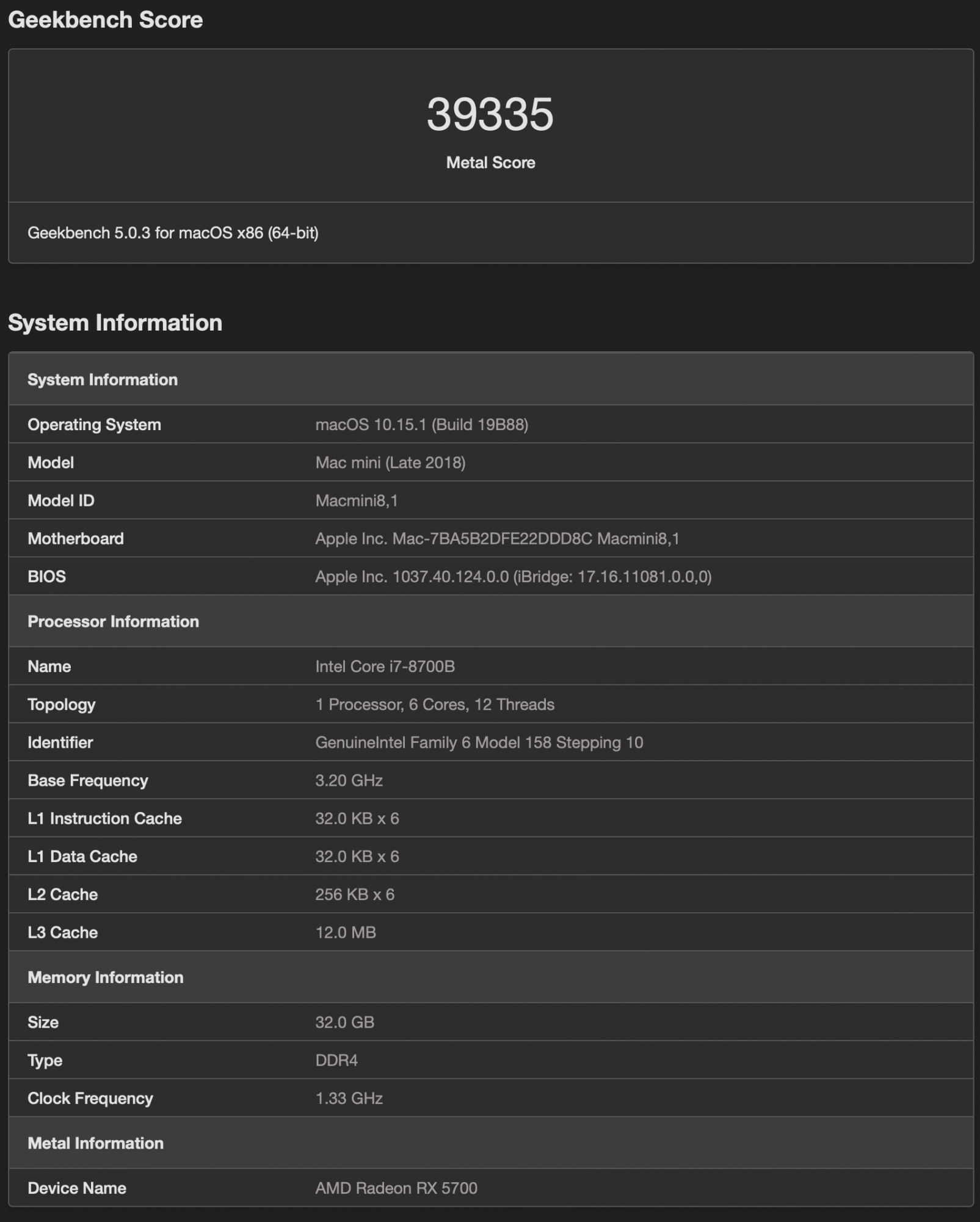

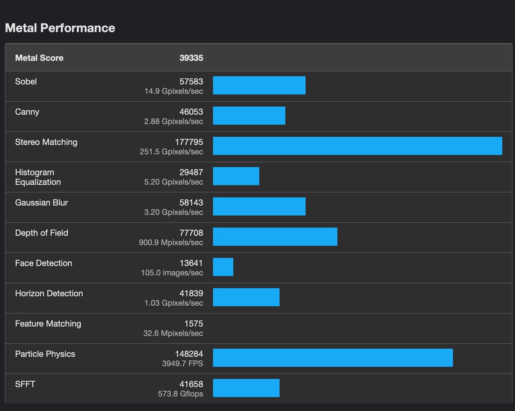

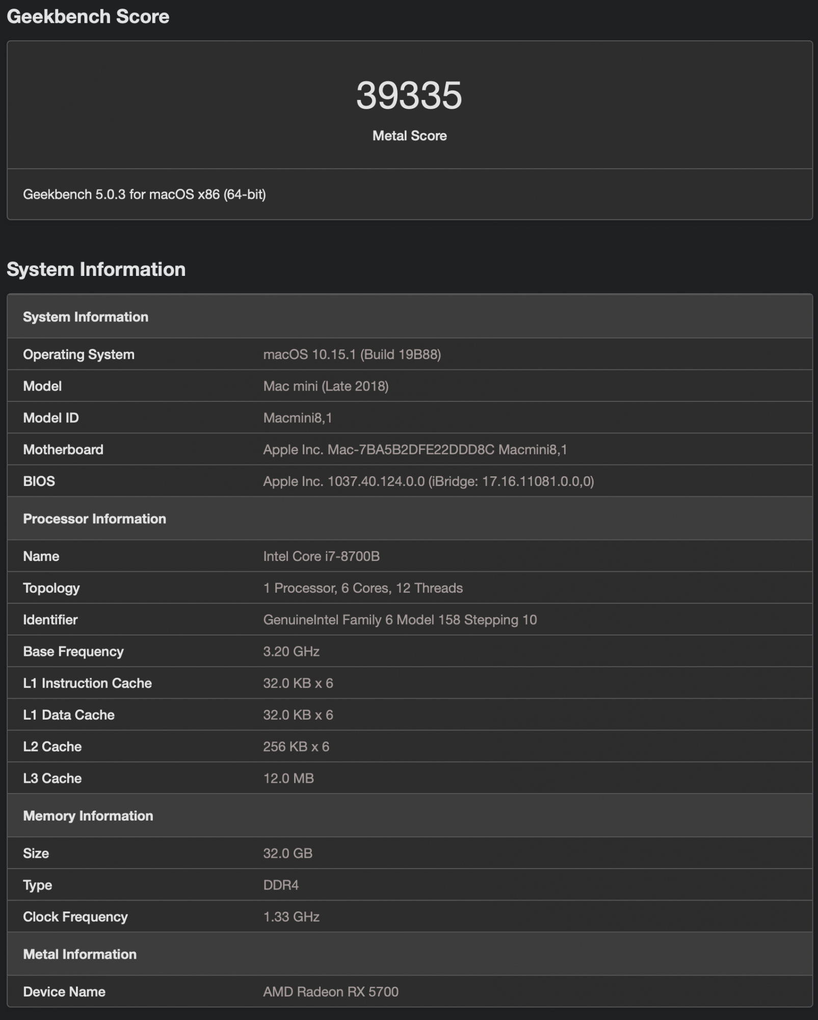

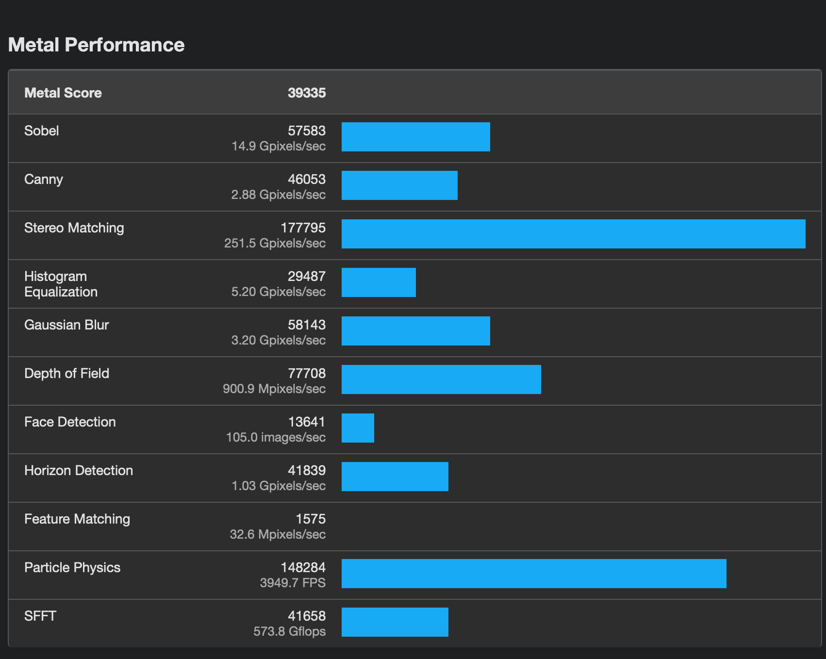

Reactions: hagjohn
Score won't be any use until I'm connected directly to the monitor, it's using passthrough mode currently.
Monitor -> Mac -> eGPU
instead of
Monitor -> eGPU -> Mac
Actually just plugged in a different monitor directly to the eGPU and got an even lower score. How strange.
Wonder if it's because I am running the silent VBIOS.
instead of
That's weird. I would have thought the XT would have been quicker. Could be silent VBIOS. I do not believe I have that on my XFX. The only thing different between our systems is the Video Card/eGPU and memory, I believe.
Could be the memory, not sure how that affects the results to be honest. I'll try again with normal VBIOS when I get a moment but I can't see the score jumping much.
