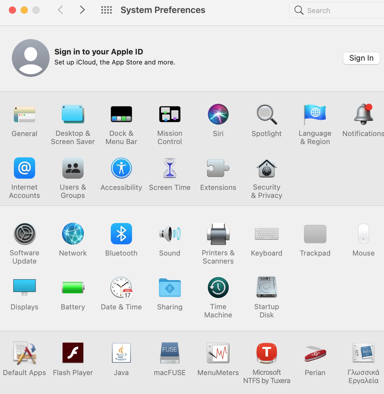

Do you have Energy Saver in System Preferences set to "Put hard disks to sleep when possible"? Even if you remember turning that off you may want to go back and check it. Apple OS updates have a nasty tendency to change some settings behind your back, especially anything iCloud related.
Where is energy saver? I cannot locate it anywhere.
I'm using a Mac Pro and it's beside the Displays icon on my machine. Maybe on your MacBook it's part of Battery?
You have Flash Player installed? No wonder you're having problems. 😱
