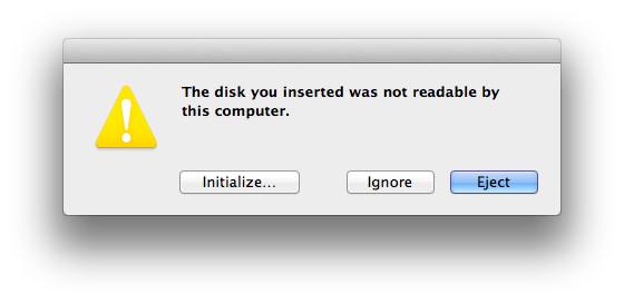

i have a external hard drive that is NTFS that won't mount it just appears in disk utility after some time connected.
I have Paragon NTFS to read it.
I can't get it to read on both Mac and Windows. (doesn't mount can't do a chkdsk)

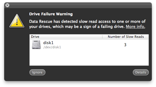

I have tried Data Rescue to try to fix it but it gives me this error:
http://www.prosofteng.com/docs/Data-Rescue-3-Users-Guide/pages/drivefailure.htm

i still had the option to format the drive with disk utility, so i did and was able to use data rescue to scan for deleted files, witch i didn't do because it would take 400 hours (the drive is very slow about to fail)
it was recovering files.
hope this helps someone with important files.
