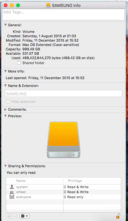

And as for the screenshot - sure - its attached to this comment and that shot is once I have opened the lock - I cant scroll any further down than that. Thanks again for your help!
First thing that I notice is the Format: MacOS Extended (Case-sensitive)
I don't ever recommend using the case-sensitive option, unless you have a specific need for that.
I don't think that would be causing your issue, but just not normally a good option for most users.
I also notice that adding a user (the (+)) is greyed out...
Can you click the drop down next to "everyone", and change from "Read Only" to "Read & Write"?
Maybe that will let you erase the drive. Reformat to Mac OS Extended (Journaled). Do not choose the Case-Sensitive option.
