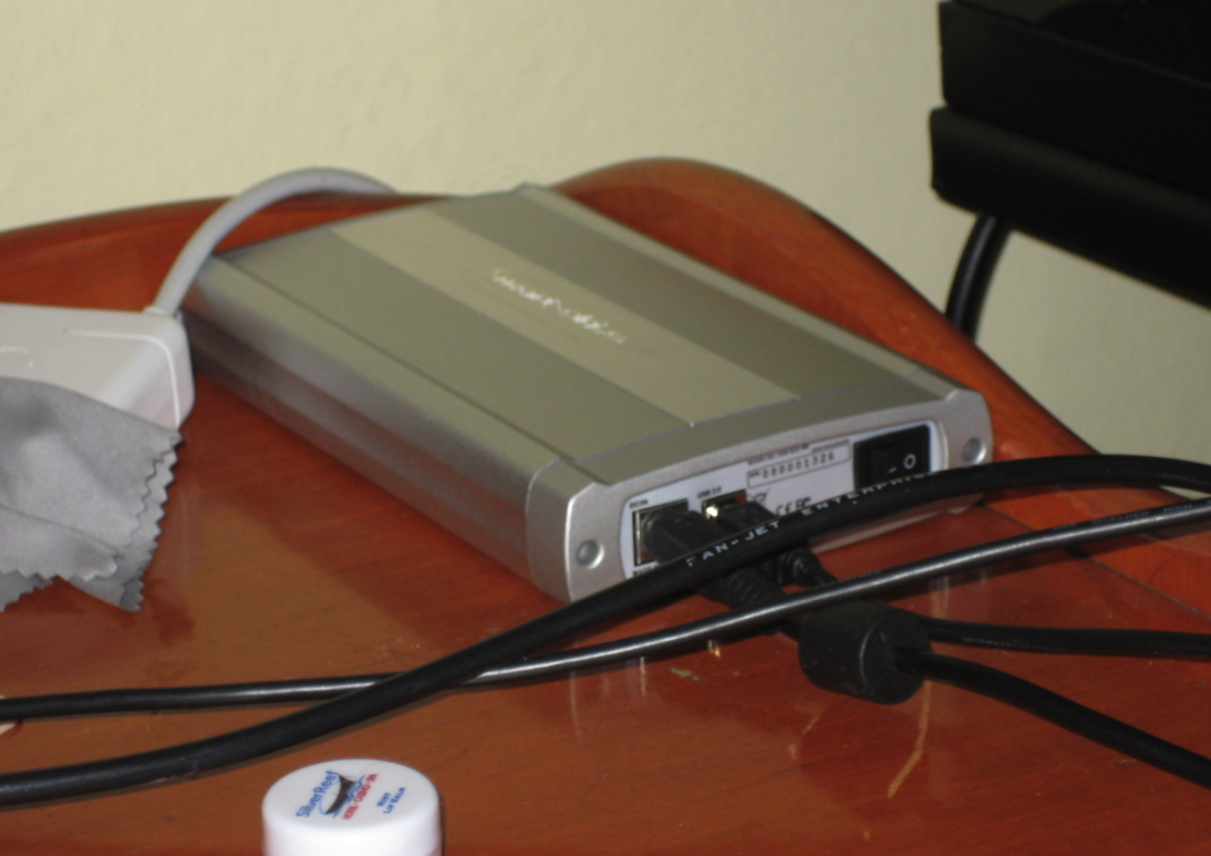

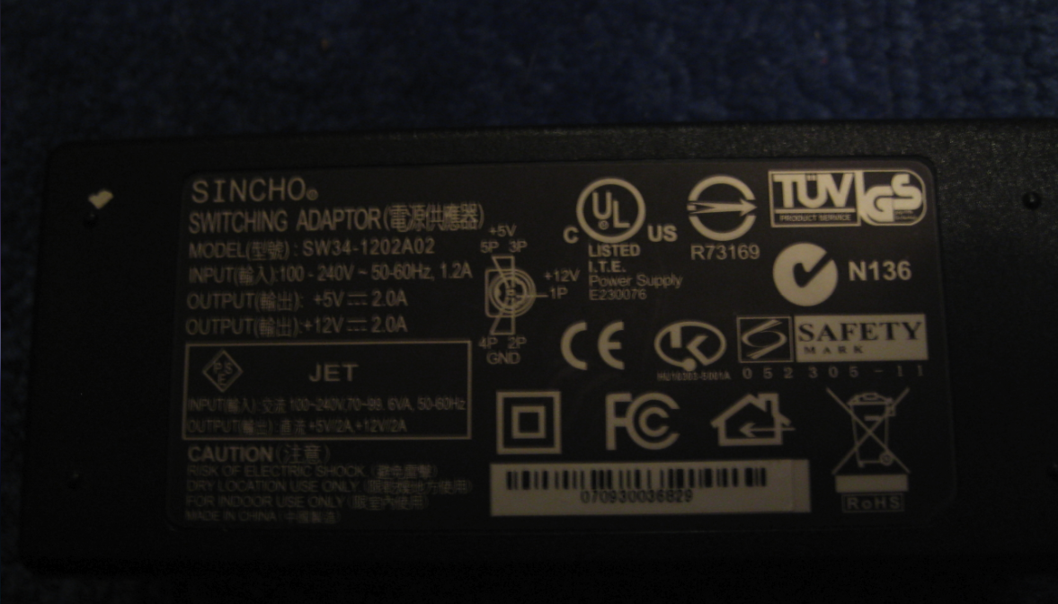

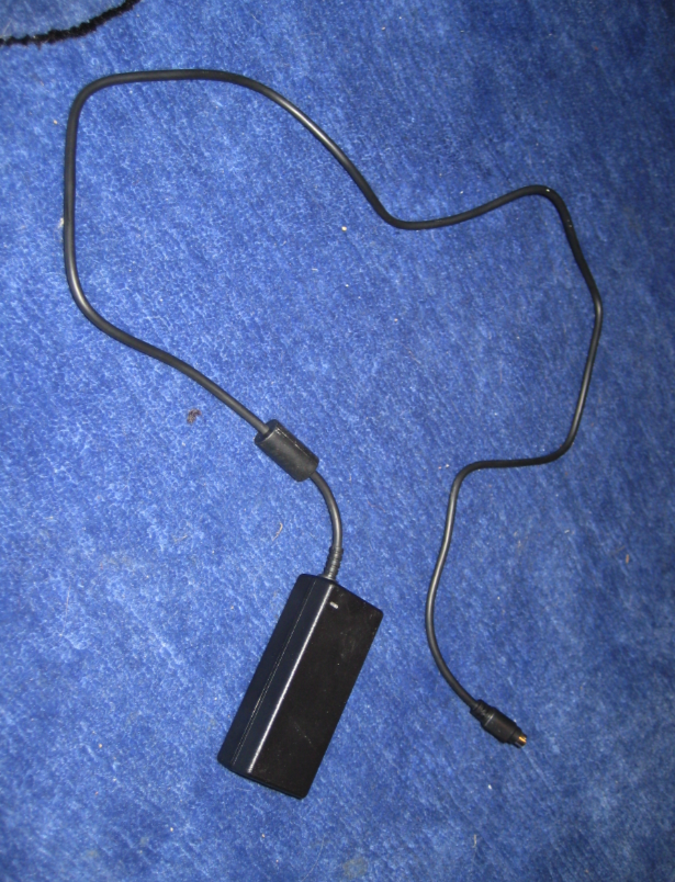

Hey I have a 500GB Western Digital SATA drive inside an unbranded enclosure that I use for Time Machine.
If I plug the drive in, it will work for about a minute, then I get an error about unsafe removal (The same one you get when you unplug something without ejecting it), I put my ear up to the drive, and it sounds like it spins up for a second, then spins down, then up again, then down, then up.......
My estimate is that some kind of power supply inside the enclosure is failing, could this be it?
What I have tried:
- Reformatting the drive
- Using the power cord from my external DVD burner (They appear to be identical)
- Placing it horizontally instead of vertically
- Throwing the drive against the wall and smashing it with a hammer repeatedly (just kidding)
This has been going on for about 3 weeks now, but it used to just be intermittent.
What could be the problem?
Thanks
One question- when you say power cord, do you mean an external power supply (either a power brick type or one that has an AC cord going into one side and a cable to be attached to your drive out the other side) or are you talking about just a straight AC cord directly to the drive (hence an unusual but not unheard of internal power supply- usually on fairly large enclosures)?
The reason I ask is that if you are talking about an external power supply type and you have replaced it with one of the exact same output voltages and current capacity and have the same results, you have successfully eliminated the power supply as being part of the issue and would then have to move on to the drive mechanism's electronics as a probably cause.
Do you by chance have another enclosure you might temporarily mount the drive in for troubleshooting?
Thanks for the quick replies 🙂
The power cord is a brick yes, but I assume there is some kind of internal power supply as well? I dunno, I'm dumb.
I don't have another enclosure, or another drive to do diagnostics, and I can't format the drive again because I'm pretty much locked out of it now. It only appears in the Finder for a few seconds before ejecting.
I tried plugging it into my dads iMac, and the same thing happens, except it isn't shown as a TM drive obviously.
The drive is still under warranty, but it's a cheap-ass enclosure with no warranty whatsoever, so I'm pretty sure that may be the problem.
