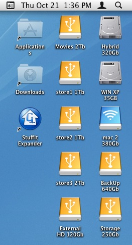

Hi ranmart,
I have 7 external HDs + 1 NAS (the blue one) hooked-up to my Mini (+ 320 GB Momentus XT inside). Here is the pict:

Hi ranmart,
Hi Stan, how did you connect 7 external hard drives to a mac mini? I need to connect 4 or 5 separate 1tb 3.5" hard drives to a mac mini.
They are all for separate things, and I do NOT want to use raid.
Thanks
