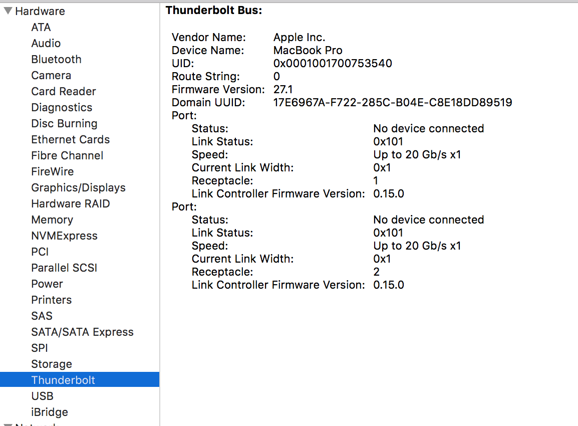

I have a mid 2015 rMPB. What connection choice do I have with it?
I do believe I have Thunderbolt but which I do not know? Same with USB?
[doublepost=1499773743][/doublepost]Just see I have USB 3 and this is the info for the Thunderport.

USB3 will be fine, that's all you need.

Although USB 3 is the cheaper drive connection, if you need speed you can get a Thunderbolt 2 drive.
It depends on how fast you want the drive to backup your files, as Thunderbolt 2 will connect 4 times faster on a dedicated hub separate from USB 3, so the point is that you can do a full time machine backup in minutes.
Reactions: jamin00
If you are buying a single-drive SATA external hard drive (SSD or HDD), Thunderbolt 2 does not mean the drive will run much faster because HDDs top out at about 250 MB/s (most are much slower) and for SSDs the SATA 6.0 Gbps protocol is one limiting factor. The biggest advantages to using Thunderbolt 2 would be to take advantage of TRIM support for external SSDs, and avoiding USB 3's ability to interfere with 2.4 GHz wireless signals. So in this case, USB3 seems like the most practical option for your need, because you will pay a much higher premium for anything Thunderbolt related.
If you are going to be traveling, I would personally favor a SSD simply because they have far greater shock resistance than HDDs (they would also operate much faster, obviously.) An out-of-the-box model like the Samsung T3 should work great for your needs because it is extremely small, well-built, and based off of a proven SSD. IIRC the 1TB models are around $300 USD. If that is too much, the 7200 RPM HGST TravelStar is a great HDD that you can get in the 1 TB size for around $60 and a USB-3 enclosure for $8-20.
