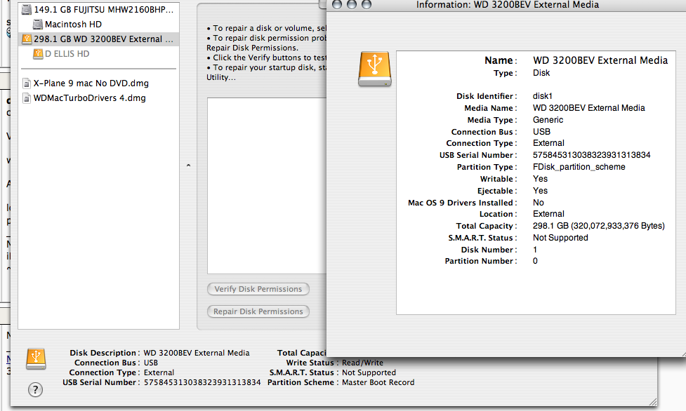

what i would suggest is go to
Apps->Disk Utility (the same application that you use to check file Permissions)
look on the left hand side and see if your drive pops up there at all. if you can, take a screen shot (by pressing :apple: + Shift + 4, then dragging the area you want to take a picture of - it will be saved to the Desktop by default) and post that picture here. maybe we can help.

wow your running Tiger, nice!
ok so see the "D Ellis HD" (the name of your partition), that appears to be not mounting. click on "D Ellis HD", go up to the top of the window and click the "Mount" button....
hopefully that will make it work!

If Only it were that easy...
If Only it were that easy...yep I've tried that before in the past. Will not mount but it will recognize it in Disk Utility.
