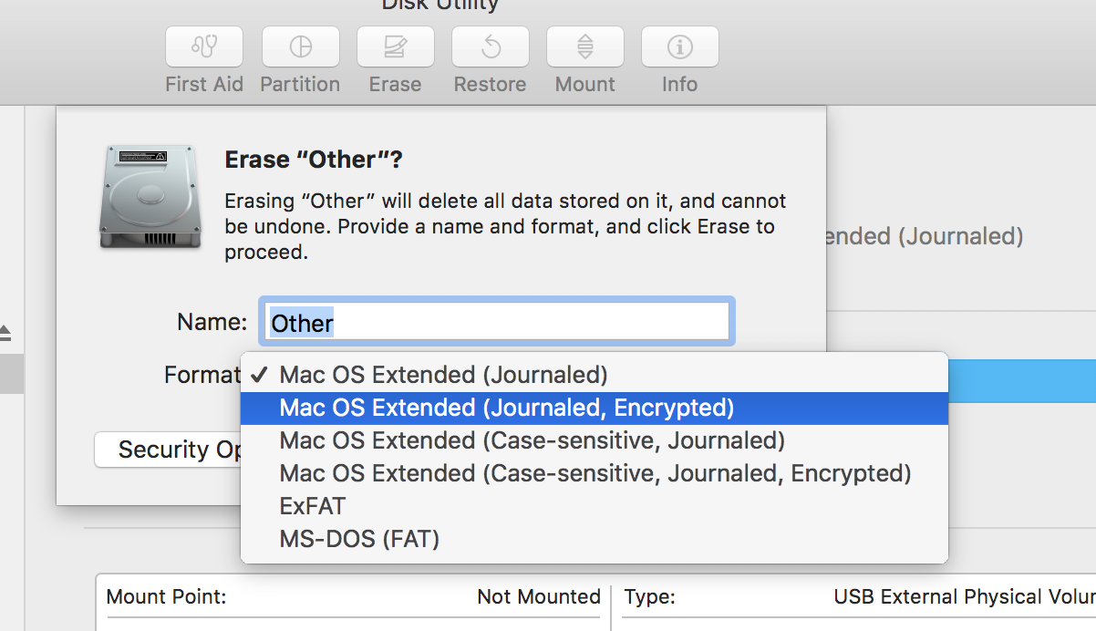

The difference is by using Disk Util it is a reformat. The right click thing you did takes the existing Mac OS Extended Journaled format and converts to the encrypted format. It is that conversion that takes time. Even more time if there is data on there. Since you have no data to lose by reformatting, it will be faster just to reformat.
Just go to the erase tab in Disk Utility and select the disk and do this. You can of course name yours whatever you like.

A Disk Util format to the encrypted format will take about ten seconds and you will be done and the drive will be encrypted.
Wow! Just perfect - your solution worked! I erased but kept it encrypted, and now Terminal/diskutil cs list shows the HD as fully secure with no progress % at all. Looks like I'm all set! You saved me so much time. I only wish I did this in the first place, but ah, live and learn.
