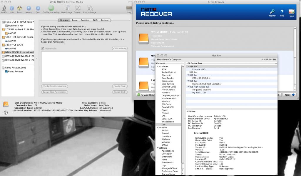

The only hope that I have for recovery is the XHD appears in my Disk Utility and System Profiler. However, I do not have the available option of verifying or repairing the disk. That being said, I am still worried as Disk Utility is reading 0 Bytes on the drive and a now Unformatted partition map scheme.

I have submitted a screen shot of my desktop so my utilities can be seen for further info. Any help and options would be greatly appreciated.

Your drive started to report errors or started to be slow to respond to the OS and the OS got bogged down which affected the other apps. If you looked at the console logs at the time you probably would have seen tons of errors.
Your only hope is to try some of the disk repair or recovery utility. There are several threads here and many on line guides. Sometimes putting the drive in the freezer overnight gets it working enough to recover data.
There are also commercial recovery houses.
The drive likely destroyed its heads, however. The drive interface is hardware and the report you see is stored by most in firmware/flash and doesn't need the rotational part to be working to see them. The partition, format, directory, and size types of things are stored mostly on the rotational part and requires a spinning disk and working heads.
