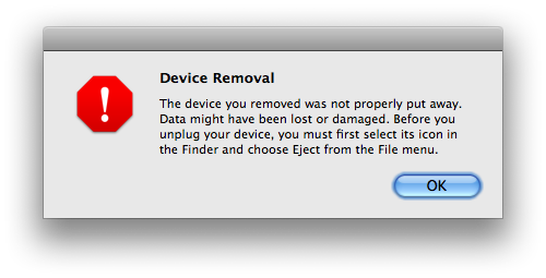

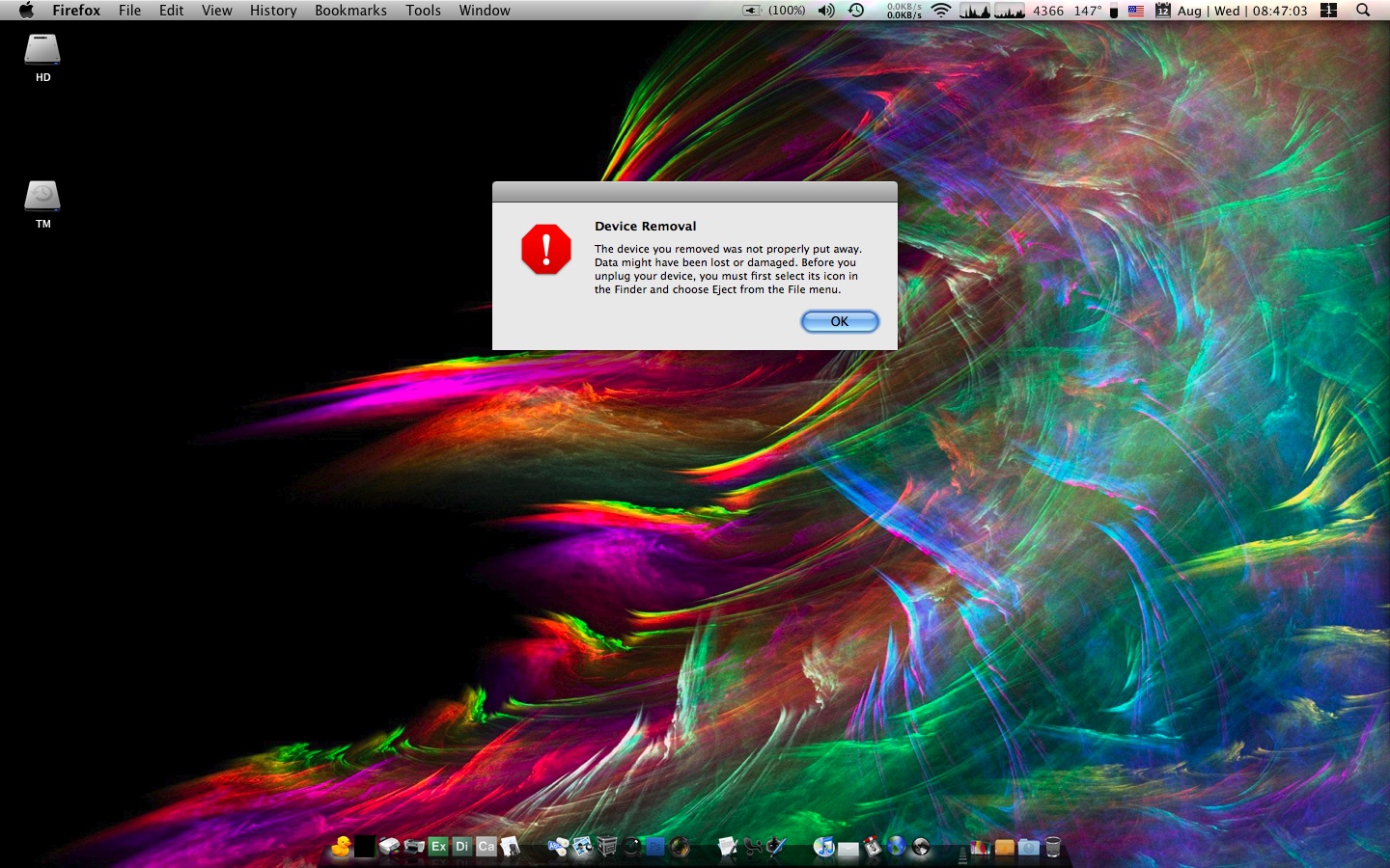

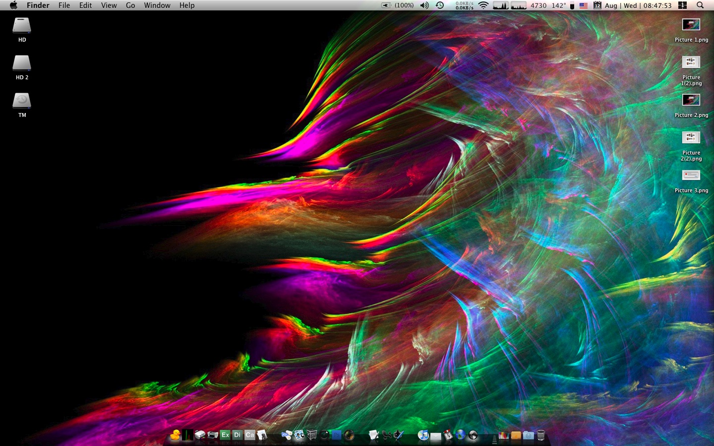

one of my hard drive keeps disconnecting randomly.
everything is well connected.
just thought i would throw in some pics.
as i was seeing what screen shots i should post it disconnected 4 times.

are we talking usb? is it on a hub? some don't like being on a hub. happened to me that way. direct connection works fine.
the power supply could be crapping out.
when it was doing it to me on the hub it also messed up the directories a bit even though it didn't disconnect while any transfers took place. i had to get disk warrior to repair it. disk utility was useless for that.
ya i have 3 external's on usb. i have a direct connect for one of them (the one disconnecting) and the tm drive and another drive on a hub.
this drive does run 24/7 (seeding for torrents)
i guess then if you can hook it up to another mac and see what happens.
i don't know if all usb ports are all one or separate circuits. but i think they all go down the same pipe, so to speak. so if all your other usb drives are working then its probably not the logic board (or so i was told about my problem) but the drive instead.
in that case it could be the power or the enclosures controller circuits..or maybe the drive itself.

Does this hard drive have an external power source (AC adapter) or is it powered off the USB bus?
If it's powered off the USB bus, that's likely your problem. See if it came with an AC adapter (or if you can buy one) and try that. The USB bus may not be providing enough power to keep it running.
I had that problem early on with one of my XTHDs. If I recall, it was just a matter of replacing the USB cable. The one I had just wouldn't stay connected securely. Keep an eye on that, and the power cable as well.
