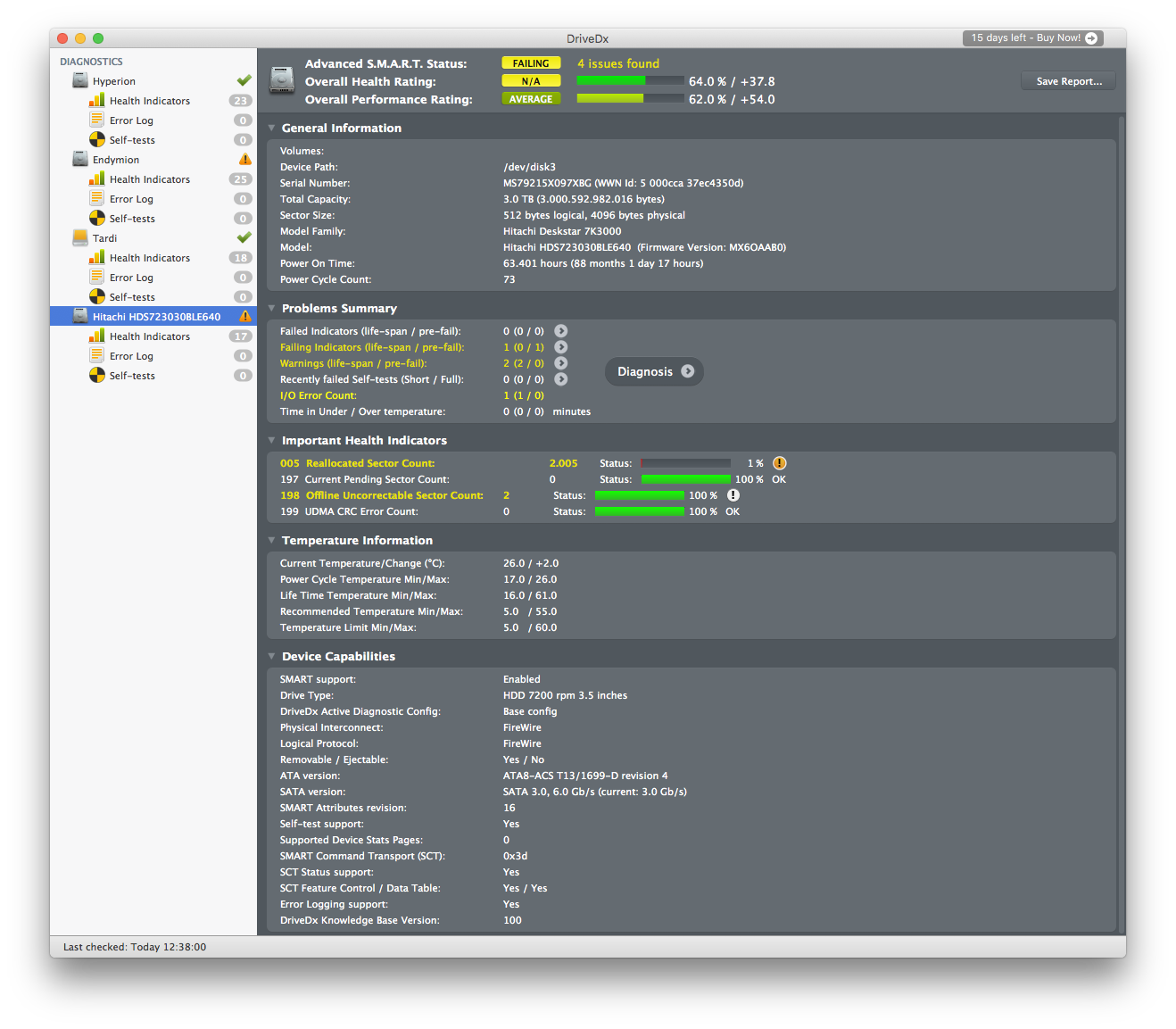

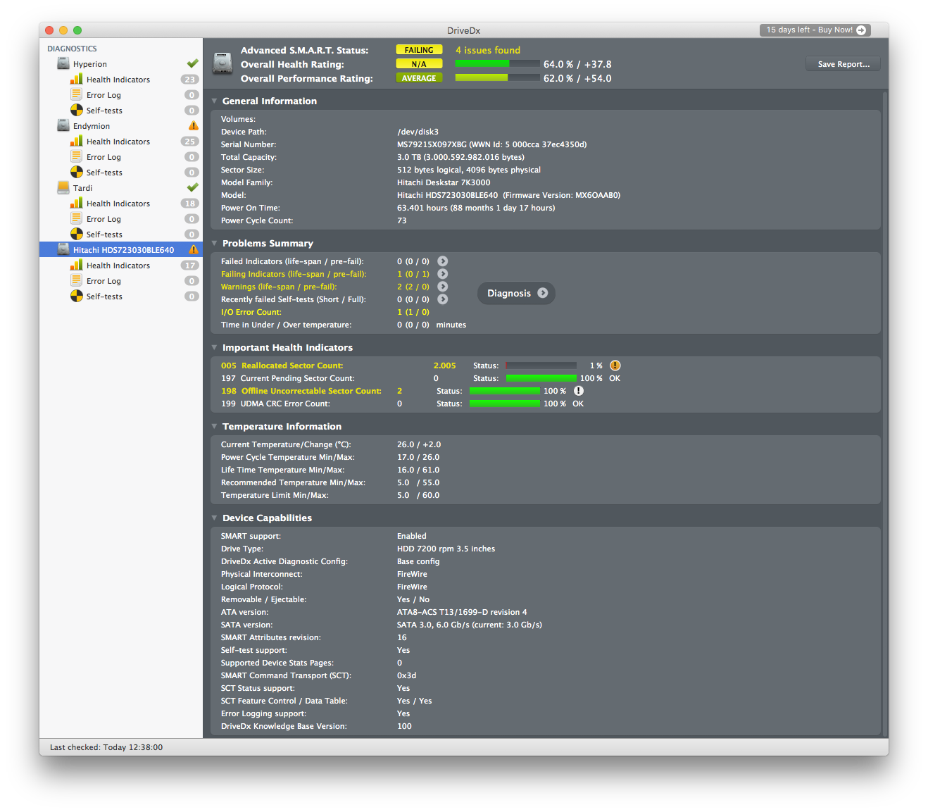

DriveDX couldn't even do a short drive test, due to a read failure on the drive... And overall it doesn't look good. I think the reallocated sector count shows that it really is dead. But great app, thanks for suggesting it!

Oh yeah...that thing is nuked. I had a feeling you would see a high reallocated sector count. Between that, the high heat, and the 7.5 year power on time, it's time to send that one to the pasture. I love DriveDX - it's such a great UI and it has consistently been able to predict drive failures for me as well as warn me when a drive is overheating.
