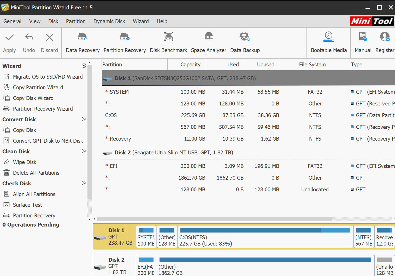

image of minitool part wizard, see bottom drive here
I assume it is showing that partition 'other' because it is formatted APFS... but ain't sure. on this particular system i would be very surprised if its is max'd out.
but am I wrong?? I thought Time Machine wanted exFat, which minitool should be able to id
