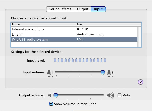

I'm intrigued by this though. System Prefs > Sound > Input has its own input volume control, regardless of what you select as your input source. See screen shot below. Is this disabled for your sound card?

Sysprefs Volume
Right, OS X disables the volume control for the input on that card. Most probably because the drivers (less than perfect, and I've let them know of the issues I have with it) for the M-Audio Sonica Theatre tell OS X that there's no such volume control.
The custom application that comes with the drivers for the card does have gain control for the input, however I have it as high as it gets, and it isn't helping much.
I _really_ don't feel like purchasing more hardware, especially since I'd also need to get a USB hub because I have no free USB ports to get the iMic working. So please, don't suggest more hardware, that really is not an option.
