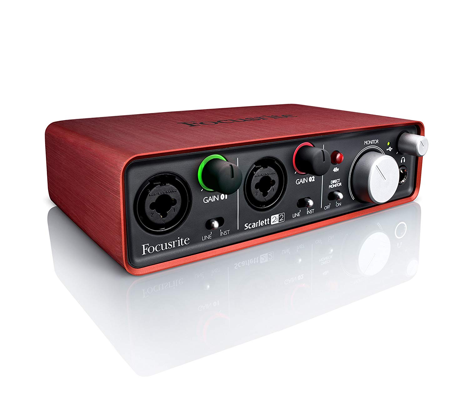

Something like this -- called an "Audio Interface" allows you to plug a microphone in one channel, a guitar in the other, and mix.
There are cheaper interfaces, of course, but preamp noise is something you should be aware of.
